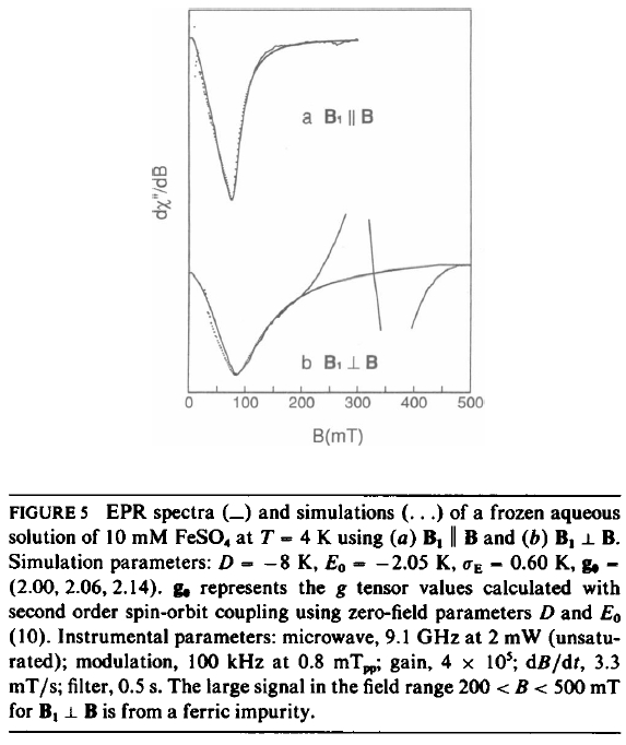

I try to simulate S=2 spectra from Fe II proteins, in parallel mode.
First of all I'd like to reproduce a simulation found in the litterature (Hendrich, BiophysJ 1989), Fig 5.a.
Here is the code I wrote:

Unfortunately, no resonance is found at 9.1GHz. E has to be increase to -1K to see something...
I can not understand why my easyspin simulation can not reproduce Hendrich's one and where I am wrong...

I have an experimental spectra that looks like the one in the figure 5.
Unfortunately easyspin seems not to be able to simulate this spectra... whatever the parameters are...
Moreover, I found some simulated spectra in the litterature. I can not imagine that they all are wrong...

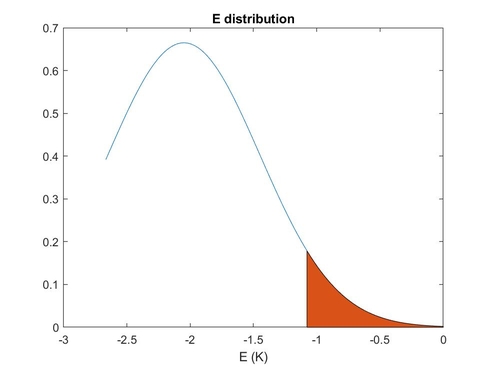

Let's determine the E values giving resonance(s) with constant D and 0=<E/D<=1/3, and see if these values are included in the E-distribution

The execution of this code gives:
The colored edge of the distribution represents the E values with resonance.
Why ES and especially pepper does not take this edge of the distribution into account, even if no resonance arises from the central value of the E distribution?
