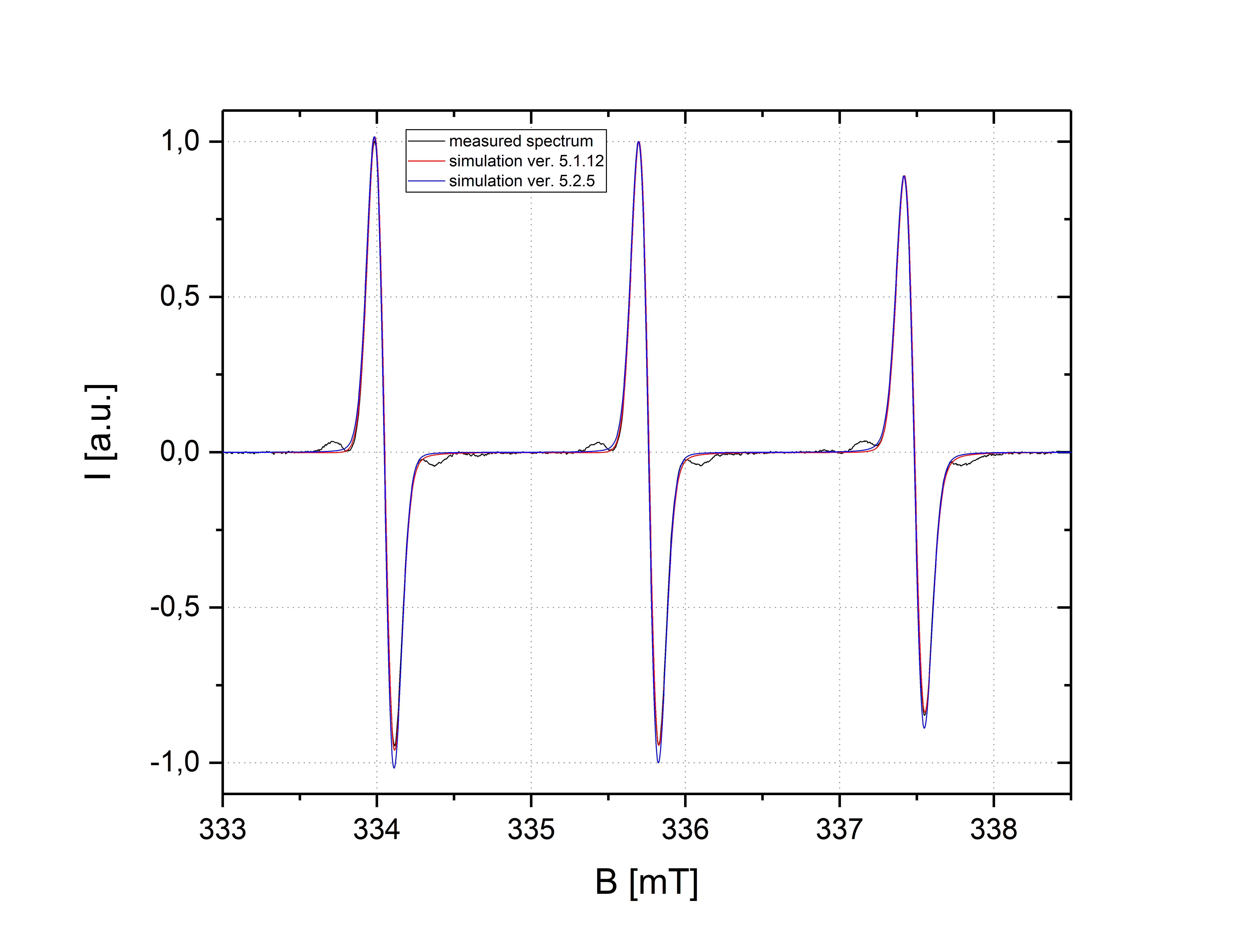

If I run a typical simulation code with chilli in the new Easyspin version 5.2.5 I get a different simulation curve as with the slightly older version 5.1.12, despite the fact that the simulation parameters remain unchanged.
As can be seen in the attached picture “simulation curves”, the signal intensities and line widths clearly differ from each other in the two simulation curves. In addition, the g- and the A-tensor-determined zero-crossings are also no longer quite the same.
Since I have already made a whole series of simulations with the version 5.1.12 (and previous versions), I would like to know what has changed in the calculation method for the simulations or how I can convert/adapted my "old" simulation parameters for the new version 5.2.5.
For better clarity, I also add the simulation code for the simulation curves shown in the attached figure as well as the corresponding verbosity logs for the two versions 5.1.12 and 5.2.5.

Re: same parameters - different simulation curves
This is a bug, thanks for reporting. It is fixed now in 5.2.6.
