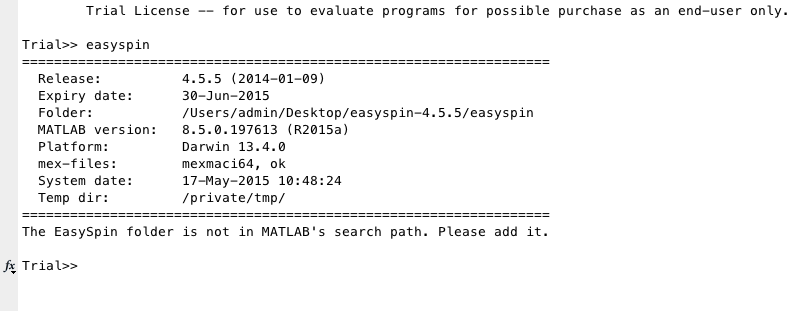

Any pro out there can advise on how I should add the folder properly? I tried watching youtube to add path properly but apparently it is not working. Could it be because I am using a trial version? Thanks for your advice!

- Screen Shot 2015-05-17 at 10.48.47 am.png (37.22 KiB) Viewed 6030 times
- Posts: 1150
Re: Can I use it as an alternative to XEPR
This is a small bug in 4.5.5. EasySpin should work despite this message. Let us know if not.
