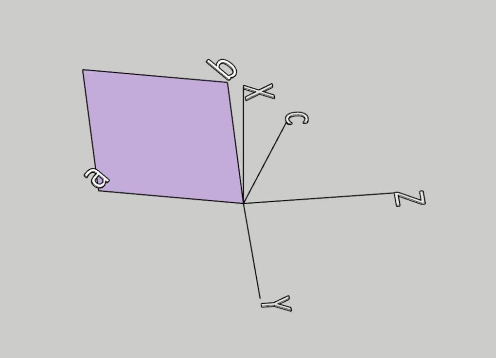

I tried to simulate the rotation pattern of a single crystal of pentacene, and now the laboratory coordinate system is known as x.y.z, Where z is the direction of the magnetic field,and the angle between the ab plane of the crystal and the x-axis is known. Most notably, we know that the yz plane of the crystal molecule and the magnetic field are at the same horizontal plane.I'm trying to find the angles between the axes in different coordinates, and then I'm trying to figure out the Euler angles, but the simulated image still did not agree with the peak position and direction obtained by the experiment. I would like to ask how I should specify Exp.molframe and cori0 now or is there any better solution to draw their rotation pettern?
Below is my coordinate system diagram and some problematic code, hope to get some pointers.
