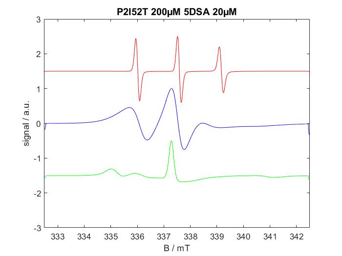

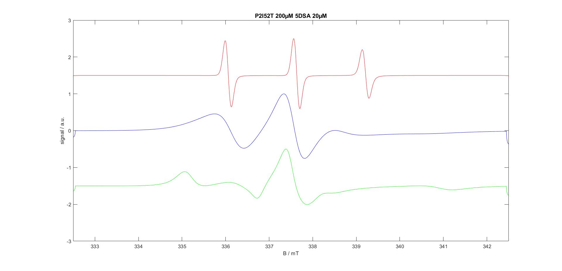

We found a problem with the function "Sys.Diff", probably a bug in easyspin version 6.0.0-dev.39. While simulating a spectrum it calculates a wrong spectrum form. The correct spectrum form can be calculated using "Sys.logtcorr" with the corresponding parameters. This error occured only in easyspin version 6.0.0-dev.39 and could not be found in version 5.2.29.
We attached two figures, with the simulations in both of the versions. The third graph (green) is calculated with "Sys.Diff", the others are calculated with "Sys.logtcorr".

Thanks for reporting this problem! Could you please post the associated script?
