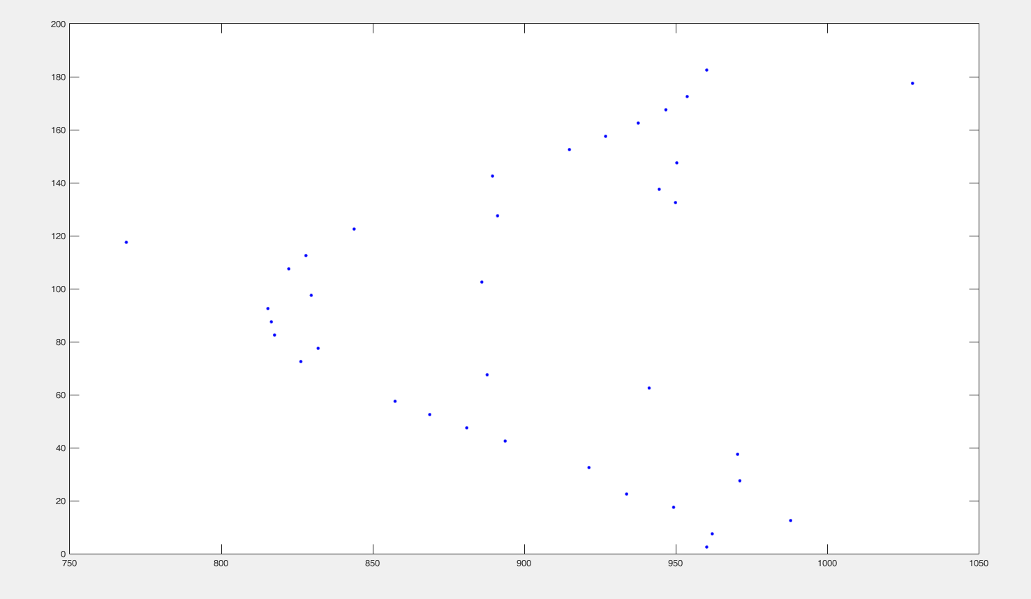

I also expected them to be similar. However the result of the program above mentioned is attached and it looks weird. It seems I cannot attach picture here (html error).

This seems very weird angle dependence for S=1/2
Maybe something wrong in Dmitry's .m file.
However I didn't find any mistakes up to now.
