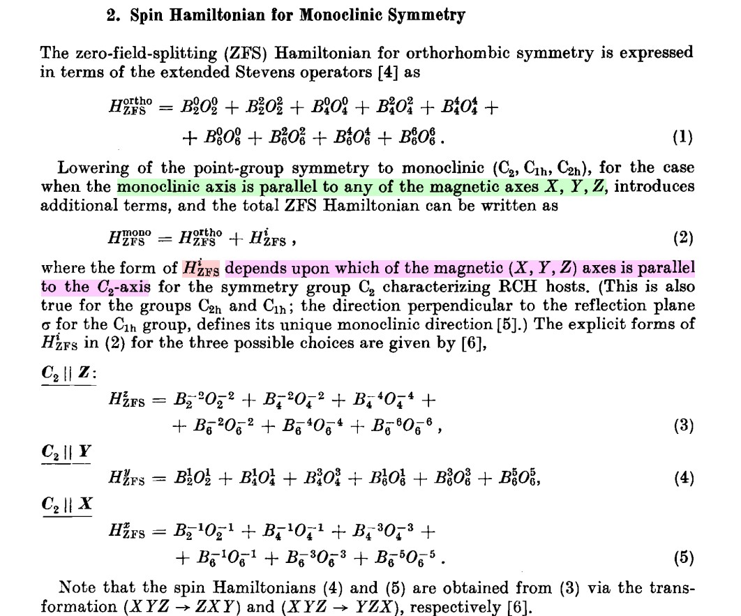

I want to simulate paramagnetic center (S=5/2) in monoclinic crystal structure (C2h) to extract crystal field parameters (B22,B20,B21,...). I anticipate that the structure exhibits orthorhombic symmetry. According to the literature, the total ZFS (Zero field splitting) Hamiltonian can be written as; H=Hortho+Hi. Hortho is orthorhombic part of Hamiltonian (related articles: https://doi.org/10.1002/pssb.2221470226, https://doi.org/10.1002/pssb.2221980229, https://doi.org/10.1080/05704928.2018.1494601). Hi is monoclinic part of Hamiltonian which depends on the diection of magnetic axes (X,Y,Z) relative to te unique axis (C2) as follows:

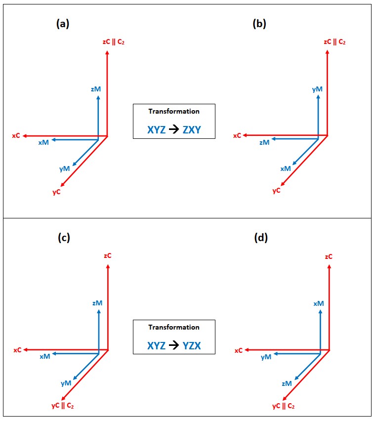

I consider the magnetic axes (X,Y,Z) in the literature (see image1) as the axes of molecular frame (xM,yM,zM) in the EasySpin documentation. yC is also chosen along unique axis (that is C2‖yC) for monoclinic point group in the EasySpin documentation. At the beginning (no orientation of the paramagnetic center within the crystal, default), molecular frame (xM,yM,zM) is assumed to be collinear with crystal frame (xC,yC,zC(means zC*, perpendicular to xC-yC plane)), as shown in Image2(c). In that case;
Q1: Should I choose Eq(1)+Eq(4) for C2‖yC‖yM (for d-orbital (S=5/2);cancel B6 coefficients), to constitute total Hamiltonian in the EasySpin code?
In the literature article, the unique axis is chosen along magnetic Z-axis (C2‖Z) and Eq(3) are used to define monoclininic part of Hamiltonian. In order to obtain Eq(4) from Eq(3), (XYZ-->ZXY) transformation should be performed, as shown in Image2(a,b). On the contrary, the unique axis is chosen along crystal yC-axis at EasySpin and this axis is parallel to molecular yM-axis (and magnetic Y-axis) for Exp.MolFrame=[0 0 0].
Q2: Can we use Eq(3) instead of Eq(4) in the EasySpin code with transformation (XYZ-->YZX) (that is Exp.MolFrame=[-90 -90 0]*pi/180))? as shown in image2(c,d)
In the EasySpin documentation; for full Hermann-Mauguin symbols, the space group symbol defines the unique axis (P211:xC, P121:yC, P112:zC). So,
Q3: Since the unique axis changes with choosing P121 to P112, can we expect the hamiltonian to change from Eq(4) to Eq(3)? ( (4): Sys.B2=[0 value 0 0 0];Sys.B4=[0 value 0 value 0 0 0 0 0] ----> (3): Sys.B2=[0 0 0 0 value];Sys.B4=[0 0 0 0 0 0 value 0 value] )

The choice of molecular frame is totally up to you. Pick the choice where the Hamiltonian is easiest to specify. If you rotate the definition of your molecular frame relative to the crystal, then you have to adjust MolFrame, as you are showing. You can use the currently undocumented tool rotview to visually examine rotations.
It is always advisable to use a simple spin system (e.g. a S=1/2 with rhombic g tensor) where you can more easily check the line positions to test whether your frame orientations are as intended.
