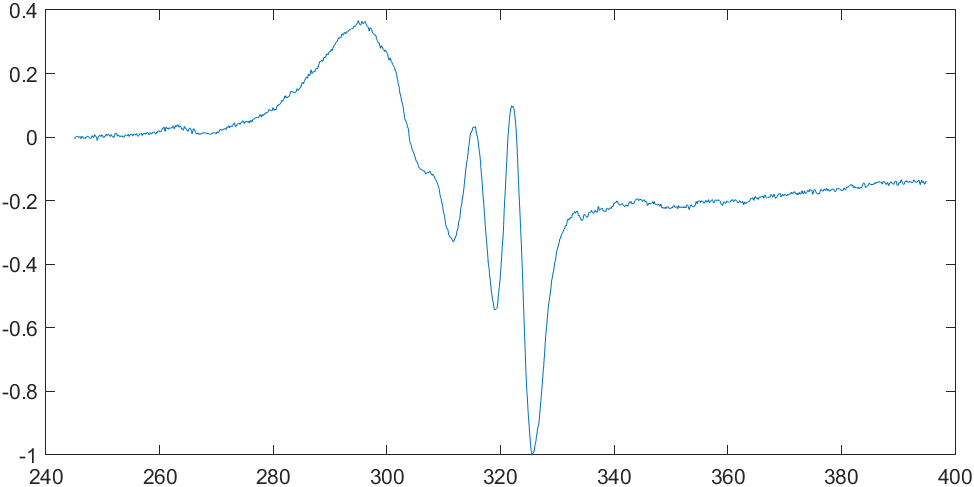

Need help with simulation of this spectrum
subhamsarkar98
Joined: Wed Sep 08, 2021 11:50 am
Post by subhamsarkar98 »
This is the spectrum I am trying to simulate.
I have been given the information that is a copper (ii) axial complex.
I am pasting the code I have written :
[B,spc] = textread('EPR_CuLClfla.txt','%f %f');
plot (B,spc);
Exp.mwFreq = 9; %Ghz
Exp.Range = [min(B) max(B)]; %mT
Exp.nPoints = numel(B);
Sys.g = [1.97 2.17];
Sys.Nucs = 'Cu'
Sys.A = [85 429]
Sys.lwpp = [0 2.3];
%Sys.S = 5/2
Sys.gStrain = [0.1 0.10];
SysVary.g = [0.05 0.05];
SysVary.gStrain = [0.025 0.025];
%LeastSquaresFitting
esfit(@pepper,spc,Sys,SysVary,Exp)
I am new to EPR and easyspin, so any help will be extremely appreciated :). Thank you!
