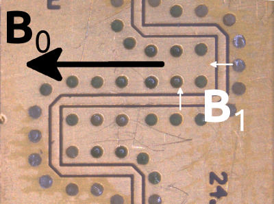

I am trying to simulate EPR spectra recorded on a coplanar waveguide.
This is shown in the figure:
Here are shown the B0 (Zeeman) field from the magnet, and the microwave B1 field from the transmission line. The sample covers the entire area, so I there should be perpendicular- and some parallel-mode signals.
The "parallel-mode" signals should also give have a distribution of (B1,B0) angles due to the cylindrical symmetry of B1 around the transmission line.
From Easyspin's documentation there is no dedicated mode for transition lines for pepper. My approach is to carry out the calculation with an auxiliary function where I would calculate spectra from different modes.
Does that seem like a valid approach?I Is there something I overlook?
Thanks!

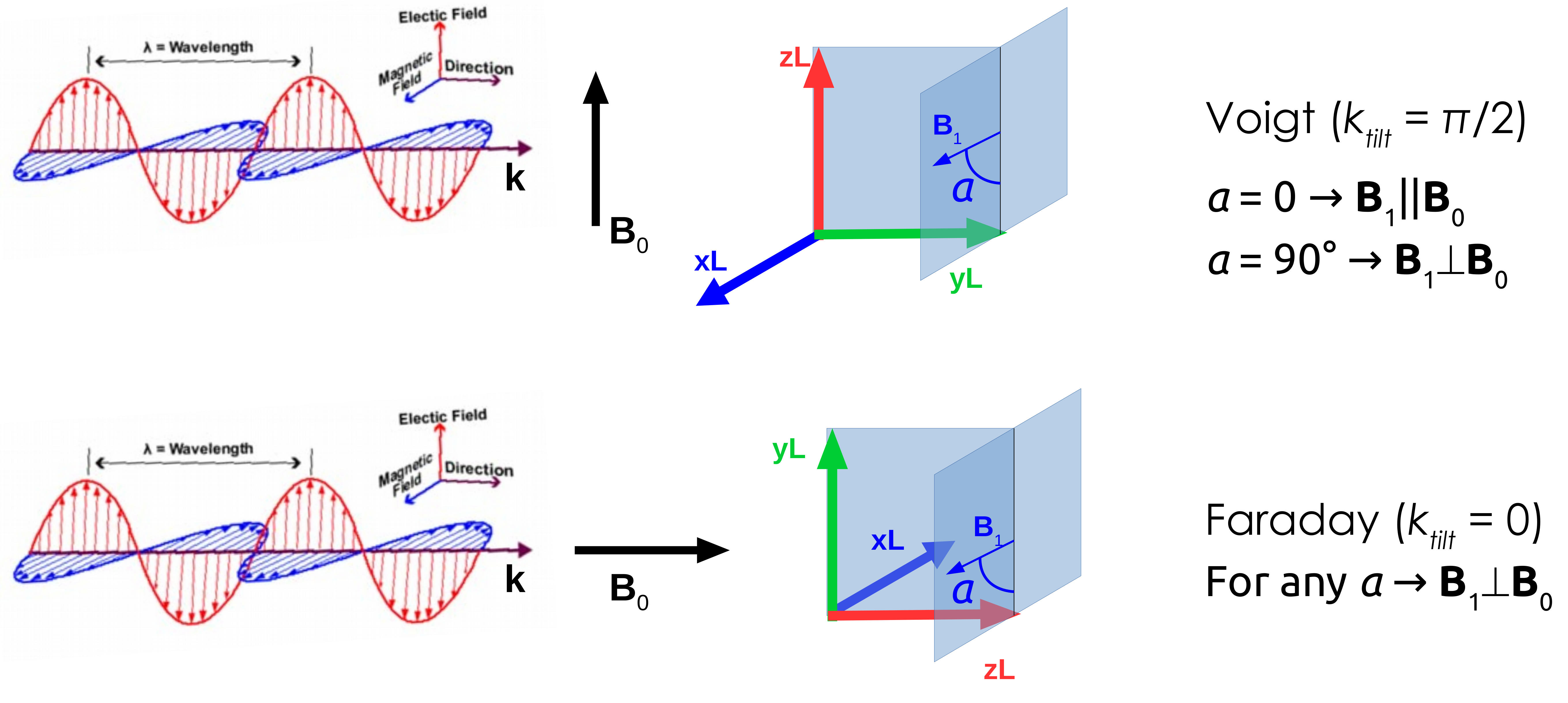

Upon carefully reading pepper's documentation, I have a question regarding the definition of the alpha angle in beam experiments.
According to the definition:
B0 is along the laboratory z axis (zL), [0; 0; 1] in the lab frame. Together, B0 and k define the zL-yL plane, where yL is the laboratory y axis.
However, in the Faraday configuration, B0 || k, so how can the zL-yL plane be defined? This subtle detail is not covered either in Fig 1 of the 2015 PRL.
Starting off from the above definition of zL, this is what I can make of the k-angle (poynting vector with B0) and the alpha angles.
Is that the correct convention?
Re: EPR on coplanar waveguide
Independent of the k tilt angle, a polarization angle of zero always means that the B1 vector has no xL component, and if the polarization angle is 90 degrees, then B1 is along the xL axis.
Here's the EasySpin code that sets up the B0, B1, and k vectors from the two angles given in Exp.Mode (called k_tilt and alpha_pol here):
nB0 = [0; 0; 1]; % unit vector along B0, in lab coordinates
sk = sin(k_tilt);
ck = cos(k_tilt);
nk = [0; sk; ck]; % unit vector along wave vector k, in lab coordinates
ca = cos(alpha_pol);
nB1 = [sin(alpha_pol); -ca*ck; ca*sk]; % unit vector along mw field vector B1, in lab coordinates
Hopefully this clarifies things.

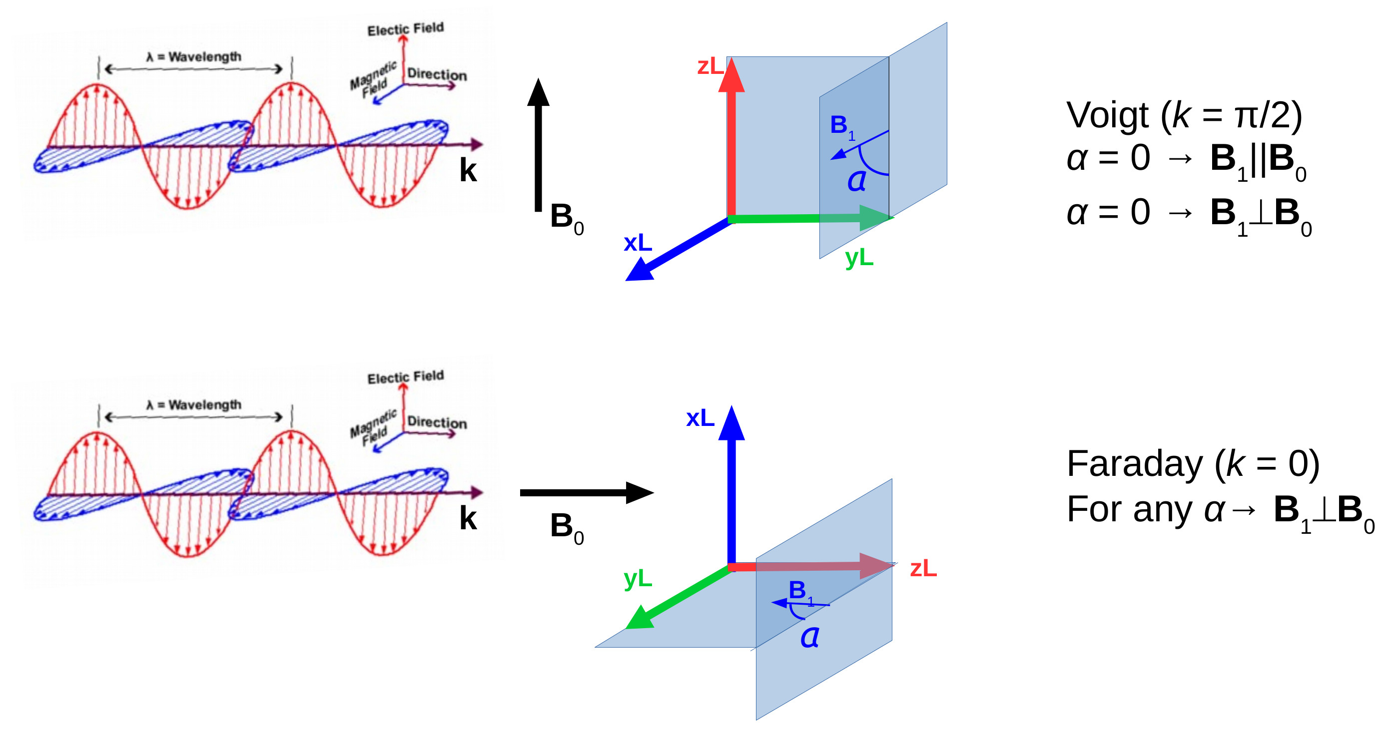

Thanks for the clarification Stefan.
I have now corrected my scheme according to your code. It is always a right-handed reference frame with B0//z. Hopefully it captures the convention:
I think in the lower plot, the alpha angle is not correct. It should go towards the +xL axis, not -xL.
