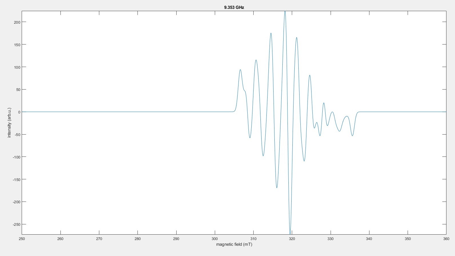

YanQing
Joined: Tue Dec 22, 2020 7:17 pm
Re: Five nucleus spin system
Post by YanQing »
From the perspective of A, the first four magnetic core splittings can be completely ignored. (Even if you work hard to figure it out, the X-band will be completely buried by the splittings of Co) .It is a simple mononuclear Co compound. So I deleted the calculation parameter items other than -Co and got the approximate EPR spectrum of this compound.
code:
clear;
Sys.Nucs = 'Co';
Sys.D = [-4.89+04,5.766+03,6.827+04];
Sys.DFrame = [-2.792,1.74,-2.609];
Sys.A = [30.74,98.45,119.8];
Sys.AFrame = [-1.29,0.5739,0.977];
Sys.g =[2.078,2.085,2.092];
Sys.gFrame = [-0.80,2.49,0.42];
Sys.xyz = [0.368,-0.8188,0.0478];
disp(Sys.Nucs)
Sys.S = 3/2;
Sys.lwpp = 1;
Exp.mwFreq = 9.353;
Exp.Range = [250 360];
%Opt.Method = 'perturb2';
% Opt.Method = 'hybrid';
Opt.HybridCoreNuclei = [5];
%Opt.nKnots = [61 0];
Opt.nKnots = [11 0];
Opt.Sparse = true;
Opt.Verbosity=1;
pepper(Sys,Exp,Opt);
