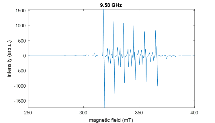

c = 2.998;
Sys.S = 5/2;
Sys.lw = 1;
gperp = 2.00123;
gtang = 2.00131;
Sys.g = [gperp gtang];
Aperp = -88.23*c;
Atang = -87.6*c;
Sys.A = [Aperp Atang];
% ZFS terms
Sys.B4 = [0 1.12 0 0 -0.047 0 0 0 0]* c; %B34 and B04 terms only
Sys.D = -76.0 * c; %consider adding Dstrain
Sys.E = 0; % consider adding Estrain
% Nuclear Quadrupole
PD = -0.176*c;
PE = 0.13*c;
Qxx = PE - PD/3;
Qyy = -PE - PD/3;
Qzz =2*PD/3;
Sys.Q = [Qxx Qyy Qzz];
% Nuclear zeeman?
gN = 1.38;
% Spectrometer settings
Exp.mwFreq = 9.4;
Exp.Range = [270 400];
Seems about correct :-)

I needed to add Sys.Nucs = '55Mn' and then it ran great.
Looks just like the literature, and just like what I get from Bruker too. Simple pleasures :-)
