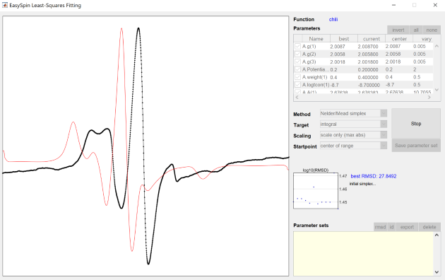

The maxabs scaling worked. The only issue now is that the fit spectrum seems like it is going to be shifted in field from my experimental.
Will this effect the parameters I obtain from the fit? If not, I'm all set, but I attach both data files in the case there is still an issue.

Re: Esfit - Warning: Rank Deficient
Field shifts occur if (1) you don't know the field axis exactly (which is often the case), (2) you don't know the microwave frequency exactly (which is sometimes the case), or/and (3) you don't know the g values exactly and you don't fit it.
