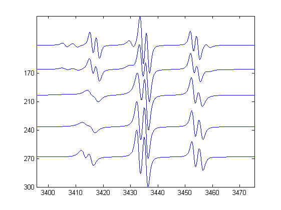

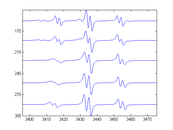

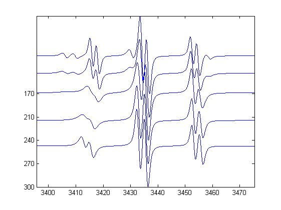

Changing of step parameter in stackplot function from 1 leads to squizing of the axis with labels. Their position does not corresponds to the spectra more. This makes labeling feature almost useless. The pictures illustrate the problem in detail.
step=0.3
step=0.3
step=0.5
step=0.5
step=1
step=1

I agree, stackplot is not useful in this case. This calls for a complete redesign of the function, including various scaling, alignment, and labeling options. We will open an issue and work on it. Thanks for the observation.

x/y labels and their range/step size can be manually specified using the set function:
 figure
 set(gca,'XTick',3395:10:3475,'YTick',[0.5:1:5.5]);
