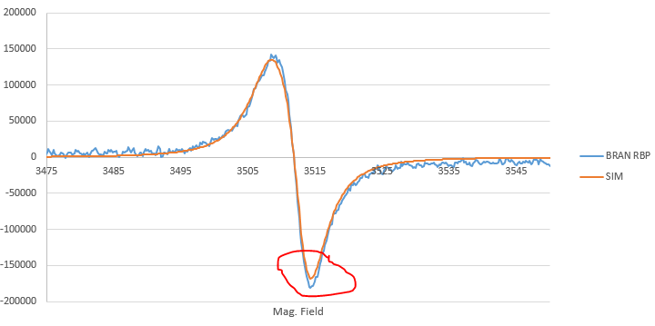

I'm going to simulate the ESR spectrum of rice as a solid sample by using the modified code from somewhere in this forum. My code is shown as

After I ran this code to simulate the spectrum, I got a difference between simulation data and experimental data like the below graphic. The red mark is the different thing that I saw. So I think the simulation line may depends on line broadening for anisotropic, but, I think that my integration signal would be Lorentzian distribution instead Gaussian distribution. What should I do for solve this problem? Thanks all for helping me :D
