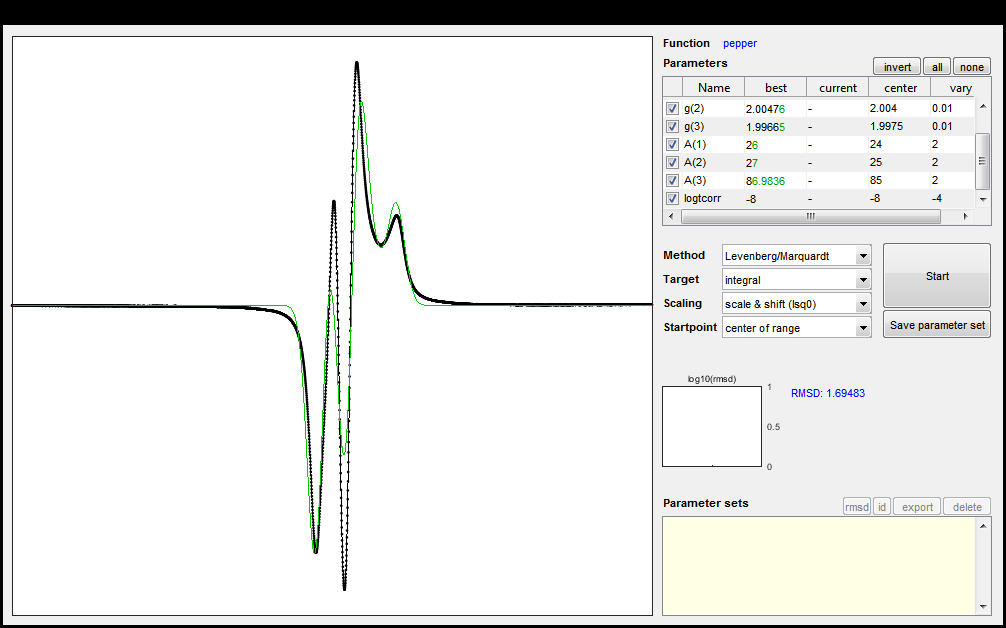

I tried to fit the EPR spectrum in Polymers samples contained TEMPO. Here is the code of Matlab that I used:
[B,spc] = eprload('PU5_2.dat');
Sys0.g = [1.9980,2.0040,1.9975];
Sys0.logtcorr=-8;
Sys0.lw = 1;
Sys0.A = [24,25,85];
Sys0.Nucs='14N';
Vary.lw = 2;
Vary.g =[0.01 0.01 0.01];
Vary.A = [2 2 2];
Vary.logtcorr = -4;
Exp.CenterSweep=[334 50]
Exp.mwFreq = 9.388065;
Exp.Range = [309 359];
esfit('pepper',spc,Sys0,Vary,Exp);
And here is the screenshot show the fit and the spectrum:
I think that there could be a distribution in parameters, Could you please show how to write the code to include the distribution to the parameters?
Thank you very much,
Cheers,
Re: Fitting EPR spectrum of TEMPO in polymer
The lines of the spectrum should contain Lorenzian broadening. Try to use Sys0.lw=[1 1]; to add it in the simulation.
Also the strains (HStrain, gStrain, AStrain) may be required. See http://easyspin.org/easyspin/documentat ... html#aniso for details.
