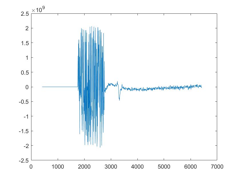

I have a problem importing spc data (with par file alongside) into matlab using the eprload function.
I use matlab version R2016a, Easyspin 5.1.12
The eprload function gives an output as required, but the spectrum looks very much distorted. i.e. there are regions with very much noise-like datapoints of very high intensity which are not shown when the data is viewed on the Bruker machine itself.

an example of such a spectum is attached.
- untitled.jpg (34.27 KiB) Viewed 3827 times

The .spc file is 4101 bytes long, which is unusual. It's not a multiple of 4. For 1024 points, it should have 4096 bytes. So it could be that the file is corrupted.
Which spectrometer and software did you use to record and save the data?
Does this file open correctly in Bruker's software? Also, check whether there was a transfer problem by transferring the files back onto the computer with the Bruker software.

Hi Stefan,
You were right, it was due to the file transfer (via FTP connection).
changing to binary mode fixed the problem.
