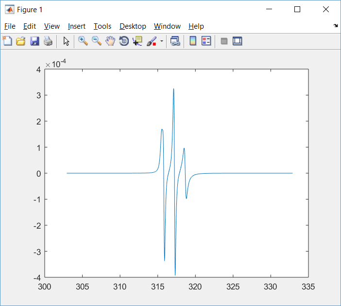

- Posts: 1085
Re: What is a proper value of "Opt.Allocation"?
Based on your code, I ran the following example:
It generated the following output:
and the following plot:
I ran this with ML 2016b and ES 5.1.6. Can you reproduce this on one of your computers? If not, I have no idea what could be wrong.

-- slow motion regime simulation ----------------------------------
field sweep, mw frequency 8.906809 GHz
field range (mT): min 302.912, max 332.912, center 317.912, width 30
harmonic 1, perpendicular mode
No ordering potential given, skipping powder simulation.
Solver: Lanczos tridiagonalization, left-to-right continued fraction evaluation
using S=1/2 Liouvillian code
Ordering potential: absent
Setting up basis set...
spatial basis: Leven max 14, Lodd max 7, Kmax 6, Mmax 2, deltaK 1, jKmin -1
spin basis: pSmin +0, pImax 2
M-p symmetry: 0
basis size: 15120
Computing starting vector...
vector size: 15120x1
non-zero elements: 3/15120 (0.02%)
maxabs 0.57735, norm 1
Computing Liouvillian matrix...
size: 15120x15120, maxabs: 1
non-zero elements: 2054856/228614400 (0.90%)
Computing spectrum...
converged to within 1e-06 at iteration 230/15120
Convoluting with Gaussian (FWHM 0.01 mT)...
