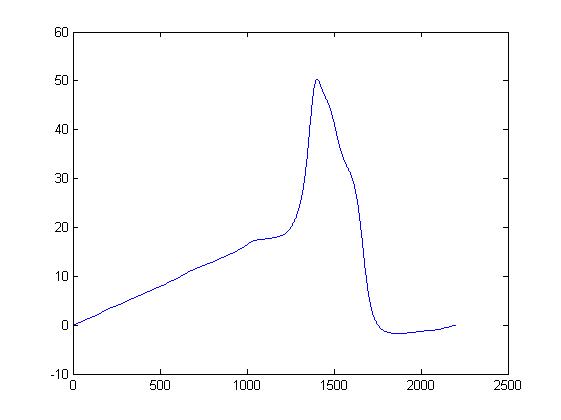

It could be that your experimental spectrum shows passage/saturation effects. Check whether the baseline is clean when you look at
plot(cumsum(real(spec))).

Thank you Stefan for your attention,
The baseline is not clean as you can see in the .jpg attached.
Moreover, I think it's possible that there is another component that overlaps with this semi-quinone anion type.
