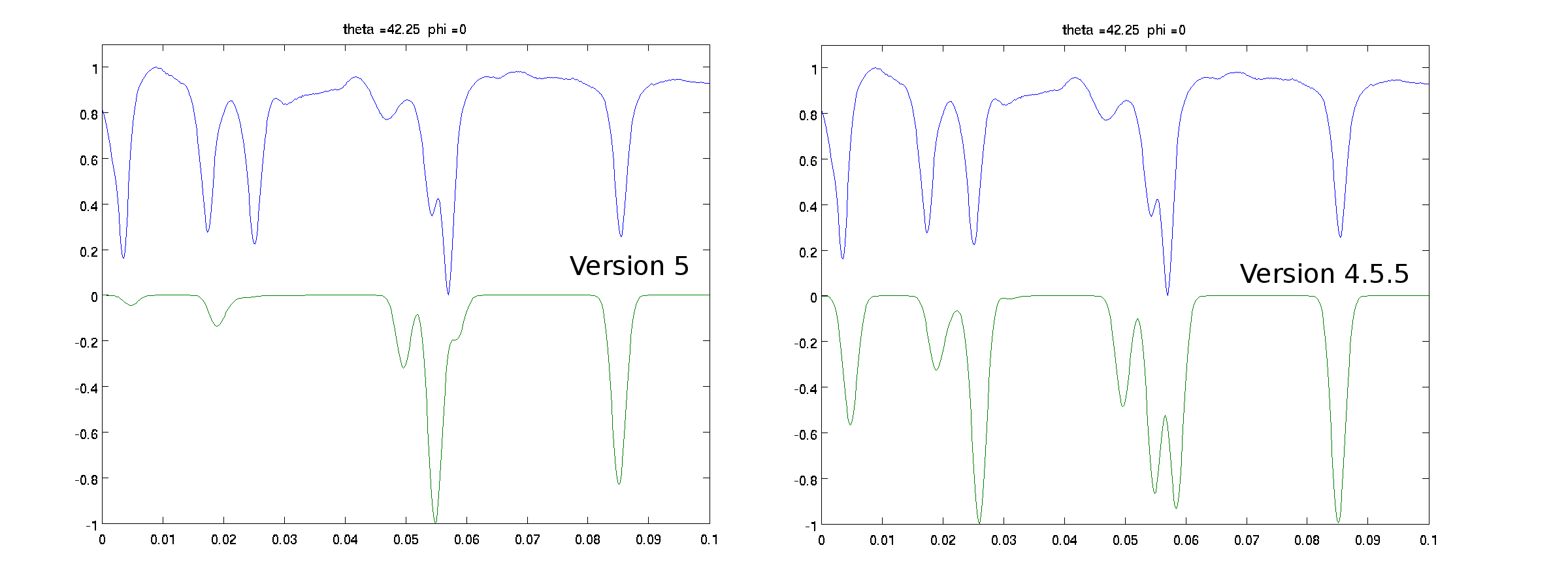

The result for both versions is shown in the attached image (I set the date back to allow me to run version 4.5.5). Each graph contains the experimental data above the simulated spectra. What could be the problem?

Re: Different results in version 5
This is indeed inconsistent behavior between 4.5.5 and 5.0.
First of all, if you have a crystal, you always need 3 Euler angles to specify its orientation in the spectrometer. Two of the Euler angles (phi, theta) determine the orientation of the crystal relative to the static field B0 and therefore determine the resonance field. The third Euler angle (chi) co-determines the orientation of the crystal relative to the microwave excitation field B1 and therefore determines the line intensity via the transition dipole moment.
The difference between 4.5.5 and 5.0 lies in what is assumed about the third Euler angle chi if you only give two Euler angles.
In 4.5.5, when you specified only two angles in Exp.Orientations, the program integrated over the third Euler angle (0..pi), essentially giving not a single-crystal spectrum, but a sum spectrum over all crystals with the same orientation relative to B0, but different orientations relative to B1. This is not a realistic situtation, and therefore it is wrong behavior and needed to be changed.
In 5.0, ES sets chi=0 if you give only two angles in Exp.CrystalOrientation. The resulting spectrum is a true single crystal spectrum.
If you want to see the effect of the third angle on the single-crystal spectra, use
Sys.g = [2 3 4];
Sys.lwpp = 5;
Exp.mwFreq = 9.5;
Exp.Range = [150 350];
phi = rand*2*pi;
theta = rand*pi;
Exp.CrystalOrientation = [phi theta 0];
[x1,y1] = pepper(Sys,Exp);
Exp.CrystalOrientation = [phi theta pi/2];
[x2,y2] = pepper(Sys,Exp);
plot(x1,y1,x2,y2);
The two spectra have the same line positions, but, depending on the spin system, different line intensities. Typically, this effect is not very pronounced. However, your spin system seems to be particularly sensitive to the effect.
Bottomline:
- 4.5.5 Exp.Orientations = [phi theta] gave a partially integrated spectrum that was unrealistic.
- 4.5.5 Exp.Orientations = [phi theta chi] gave a true single-crystal spectrum.
- 5.0 Exp.CrystalOrientation = [phi theta] is interpreted as [phi theta 0].
- 5.0 Exp.CrystalOrientation = [phi theta chi] gives a true single-crystal spectrum.
Probably, the best solution forward for ES is to not automatically supplement the third Euler angle and to always require it as input.
Thanks for pointing out the inconsistencies in the examples. We'll fix them.
Hope this helps.

Thank you very much for the clarification. This has solved my problem and helped solve a lot of my doubts about how ES treats different crystal orientations.
By pure coincidence, the old behavior corresponds more closely to my experimental conditions than the new behavior. In any case, I can now reproduce either type of spectrum.
