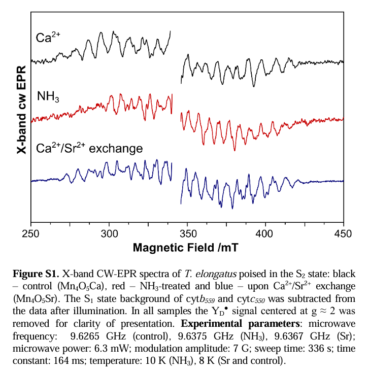

I hope this message finds you well. I am currently working on reproducing an X-band CW-EPR spectrum of T. elongatus in the S2 state, as shown in the attached figure (Fig. S1). I would greatly appreciate any guidance on how to achieve this simulation using EasySpin.

In all samples, the YD° signal centered at 𝑔≈2 was removed for clarity. I am using EasySpin to simulate similar EPR spectra, but I am facing challenges in replicating the exact line positions, intensities, and spectral features, particularly the modifications observed in the S2 state after ammonia treatment and Ca²⁺/Sr²⁺ exchange.
Would anyone be able to provide insights or a sample code to help reproduce this type of CW-EPR spectrum using EasySpin? Any help or suggestions would be greatly appreciated.
Figure S1..png (124.68 KiB) Viewed 19785 times
Re: Request for Help to Reproduce X-band CW-EPR Spectrum in MATLAB Using EasySpin
Have a look at the example in examples/solidstate/photosystem2_oec.m - this should be exactly what you are looking for.
