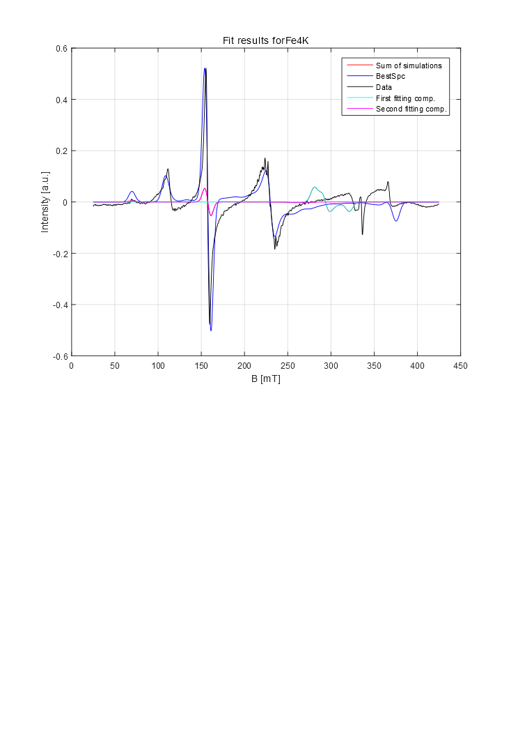

Hi there,
I just started to work with easyspin a few days ago but I recognized some strange effect using esfit with pepper. I try to fit a spectrum at 4 Kelvin with two Fe-states by using esfit. After that, I take the results of esfit and simulate each Fe-state on its own with pepper to get the single effect of each state. Finally, I take the sum of the simulations which should be equal to the result bestspc of esfit. Surprisingly it is not. Even if I would try to rescale the simulations, I wouldn't receive the bestspc result. I attached a plot which shows my problem.

(the sum of simulations is overlaid by the single simulations)

Take note of your spin in Sys1.

thank you for your quick reply. I changed the spin, so that the spin states are the same now. Additionally, I recognized that the plotted overlay code isn't the same as in my used code (obviously it must be scalingFactor = 1/(max(overlay)-min(overlay))), I corrected that and now the plots look identical. Thank you for the hint.
