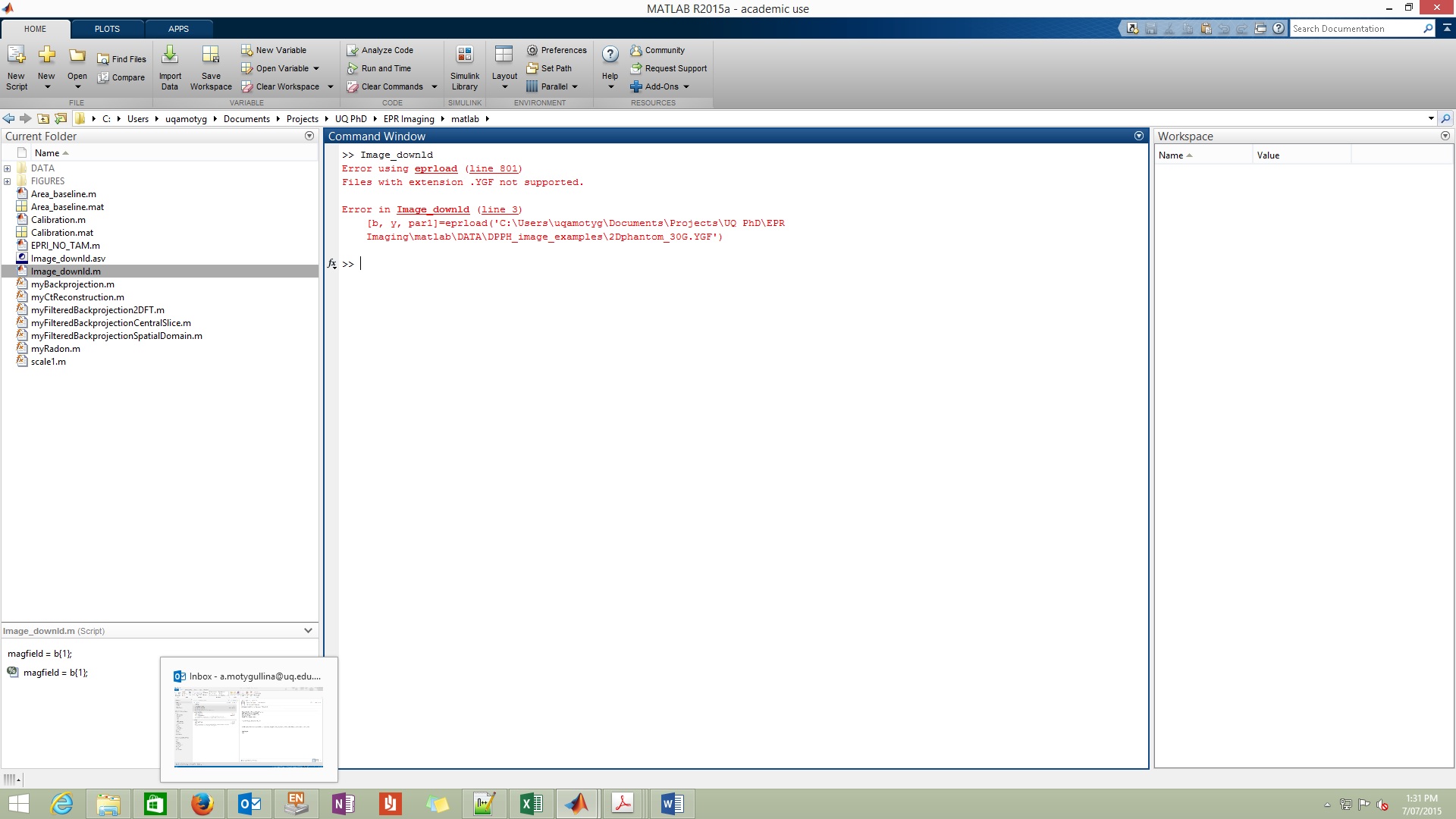

So it does not upload only -.YGF file actually. Tried again upload -DTA/-DSC files and was pretty happy to receive a big matrix of the data for different projections. At least now presumably I can use radon/iradon, conv/deconv matlab functions to reconstruct the image, and, as a long perspective, simulate imaging spectra as well.
YGF error.jpg (249.74 KiB) Viewed 6225 times
Re: EPR imaging-reconstruction of EPR images via matlab
The YGF file is an auxiliary file to the DTA and DSC files that contains information about the y axis. Any stored EPR data necessarily has at least a DTA and a DSC file. The YGF file is not always present. It is present e.g. if the y axis is nonlinear.
Don't worry that eprload doesn't directly take YGF as an file extension. Just supply the corresponding DTA or DSC file name. eprload always loads all files (DTA/DSC/YGF, etc).
