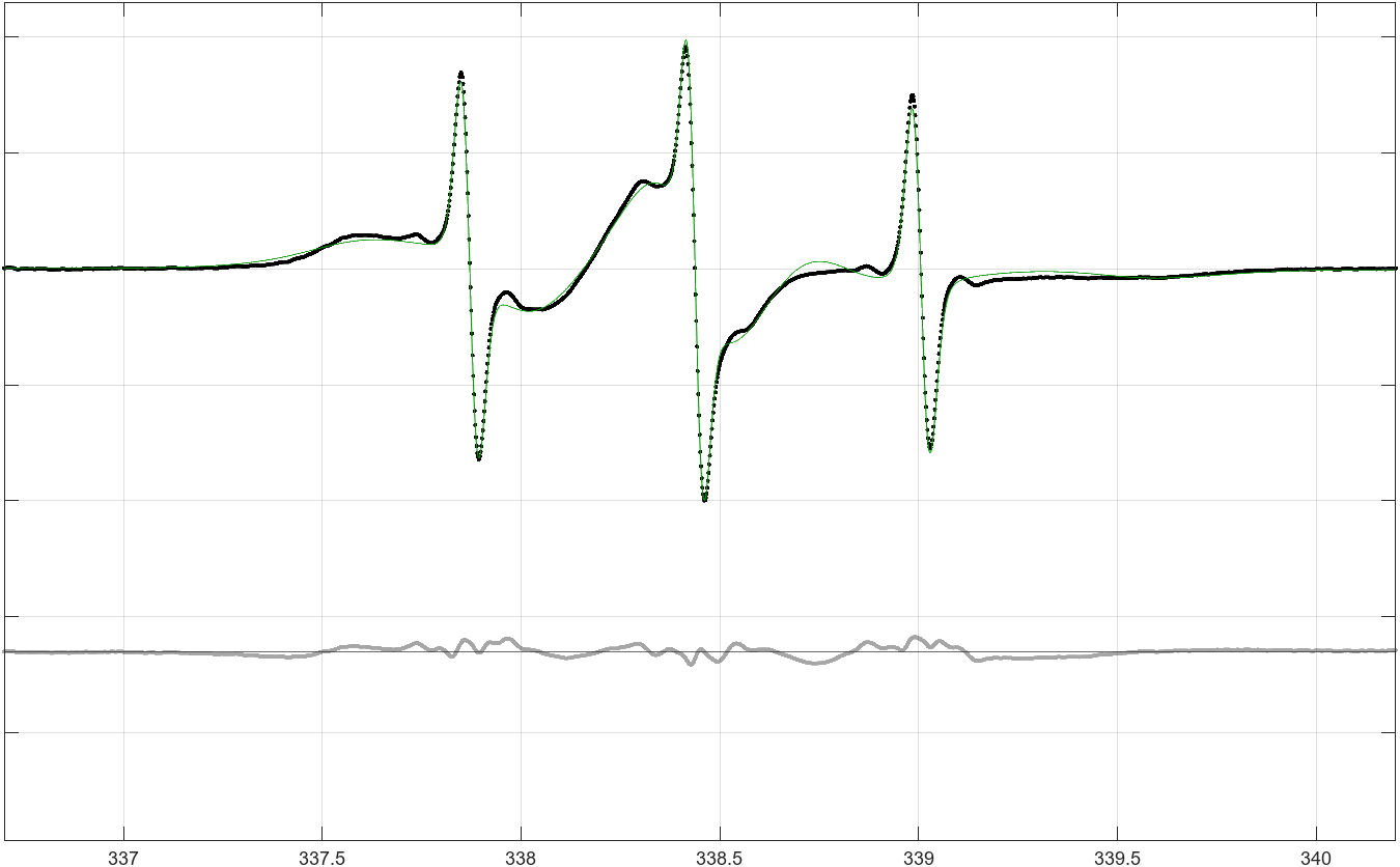

Hi, I am a new user trying to fit two component epr spectra, I used the following code. I think i get the fitting, but i am unable to separate the two component from the fitted data. How can I get the two component graph separately? please help me.
Fitted data.png (28.83 KiB) Viewed 7021 times
