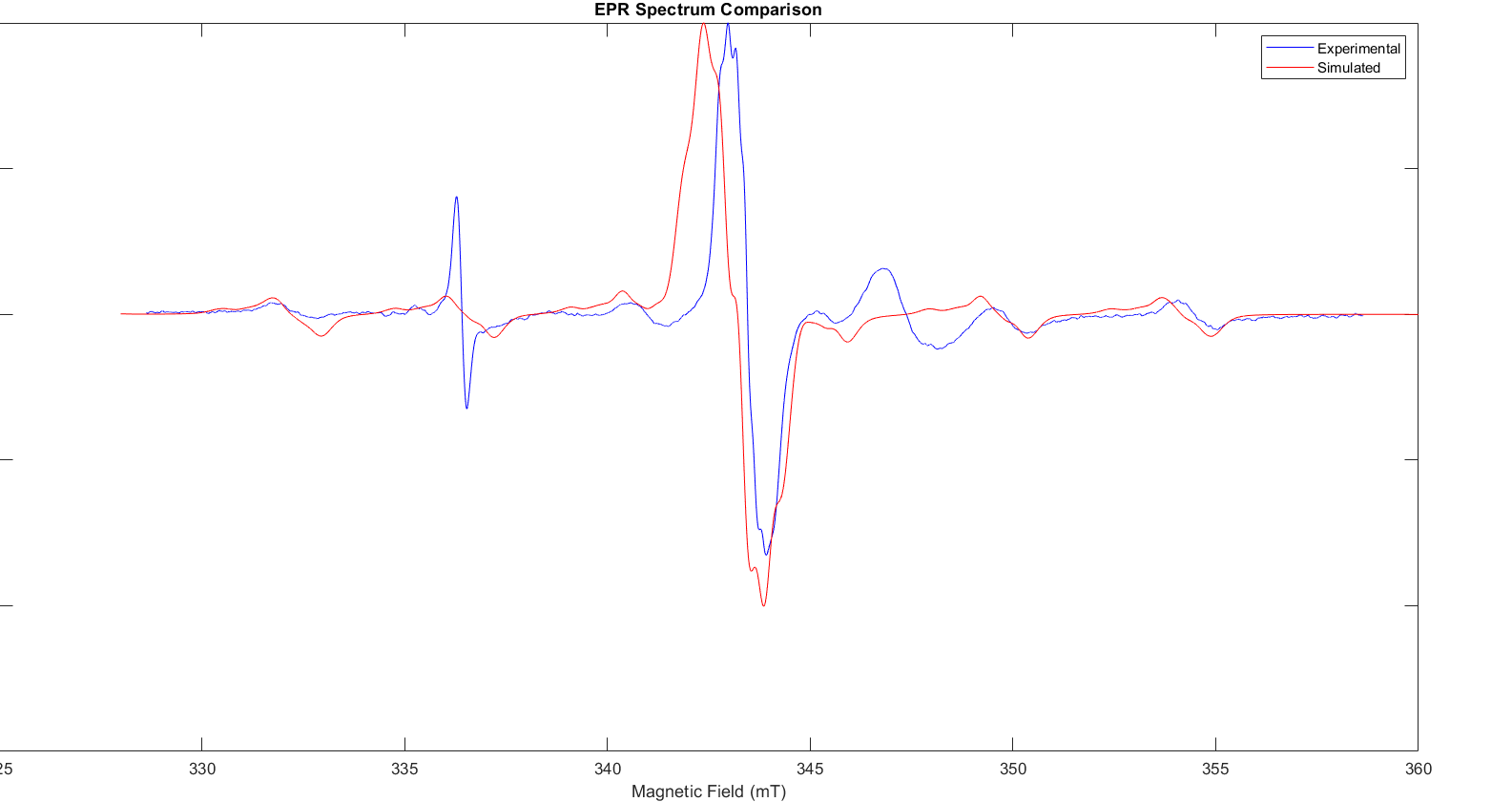

I am new to the simulation of EPR spectra using EasySpin. While I have understood the basics of simulation and fitting, I am facing challenges with fitting the EPR spectra of metal-radical complexes. Specifically, I encounter difficulties due to limited resources for measuring EPR spectra at low temperatures. For fast-motion EPR spectra, I use garlic, but the fewer peaks make it hard to understand the hyperfine coupling of the radical electron with nitrogen atoms in the ligand and the metal.
I've tried using pepper and chili, but I am unsure about the correctness of my code. For example, here is my code for simulating the EPR spectra of Mo(V) bonded with two chloride ligands and a bidentate radical (with two nitrogen atoms).

I have attached the experimental spectra for reference.
Experimental EPR Spectrum
I would appreciate any guidance on how to accurately define the spin system and improve the simulation and fitting process. Thank you in advance for your help.

If you have a structure of your complex, it might be worthwhile to perform a DFT calculation to obtain reasonable g and A values that you can use as starting values for a fit.
Are you sure the g values for your radical are <2? Typically, they are above 2.0023.
Your dipolar coupling appears quite small - it might be completely averaged out at the t ns correlation time scale you are using.
If you are looking at a ligand radical directly bound to Mo(V), consider the possible presence of an exchange coupling.
