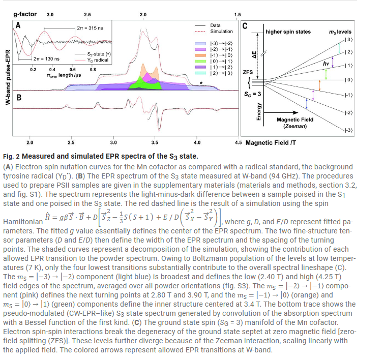

Hi all,
Is the A B C in Figure 2 in the literature simulated by easyspin? If so, how to simulate it?
DOI:10.1126/science.1254910
Regards,
Lu

The figure does not provide the fitted values of D, D/E and g, but here's a starting point:
clear, clc
D = 5000;  % D, MHz
DoverE = 0.3;  % D/E
g = 2;
Sys.S = 3;
Sys.g = g;
Sys.D = D*[1 DoverE];
Sys.lwpp = 40;  % mT
Exp.mwFreq = 94;  % GHz
Exp.Range = [1800 4500];  % mT
Exp.Temperature = 7;  % K
pepper(Sys,Exp)
