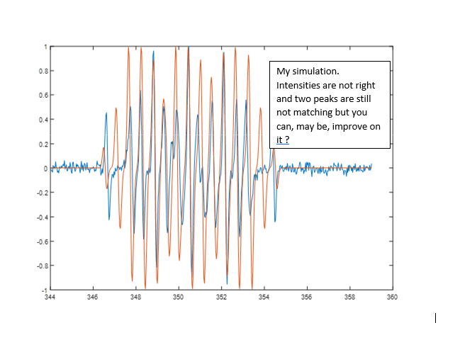

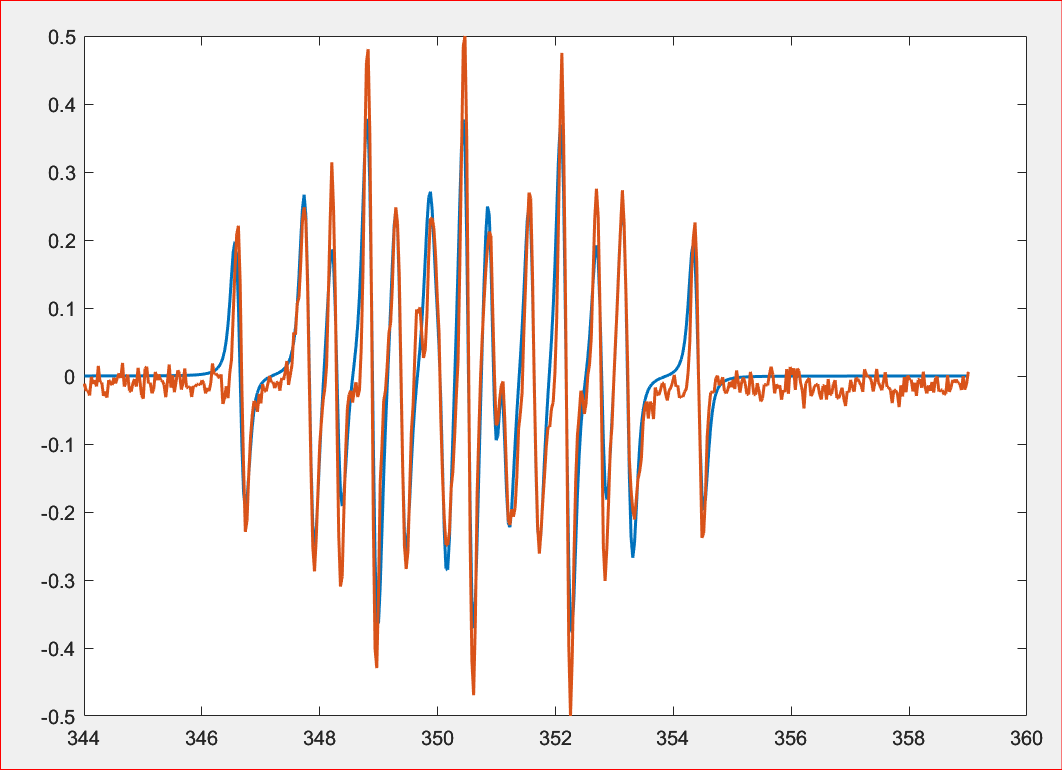

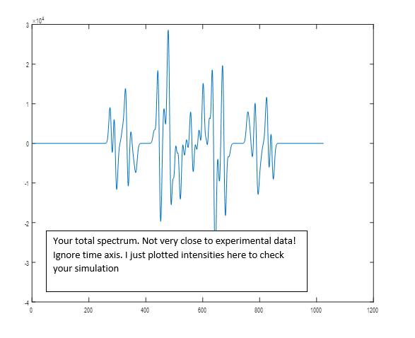

You summed up several EPR spectral simulations and I am not sure if it is realistic.
Your total spectrum does not resemble the experimental data (see attachment)
Here is my simulation and a comparison to experimental data (it is not quite right but close).
If you can refine my simulation code and may be correct it, you could obtain something quite right (see my code below).
clear, clc, clf
[data_one, data_two,exp_parameters]= eprload ('500_uM_struvite_photolyzed.spc');
plot(data_one/10, data_two/max(data_two)); % checking experimental data
Sys.S=1/2;
Sys.Nucs='14N,1H,1H,1H';% this is not necessarily true but you could think more about this
Sys.n = [1 1 2 2];% arbitrary for now but think from this perspective
Sys.g=2.0127; % randomly shifted the spectrum, so...
Sys.A=[41.5 21.96 11.7 10.26];% literature values my not necessarily describe your sample especially in a random system like adducts, so I started with these values
Sys.lwpp=0.099;
Exp.mwFreq=9.8415;
Exp.Range=[345 355];
Exp.nPoints= 512;
Vary.A = [10 10 10 10];
Vary.g= [0.05];
Vary.lwpp = 0.05;
[B2,spc2]=garlic(Sys,Exp);
plot(data_one/10, spc2/max(spc2))
esfit(@garlic,data_two,Sys,Vary,Exp) % not outputting simulation yet
return
