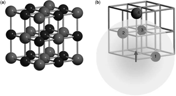

In the book "Electron paramagnetic resonace: a practioner's toolkit" chapter 13, p.494-497 I've found out the iteresting example. There is in figure 13.8 simulation of the EPR spectrum of the F center in KCl considering the first and second coordination spheres only. I've written a code using Euler angles for the first coordination sphere, it was simple, but I can't understand how to describe the second sphere. I mean, I've determined Euler angles for the second one, but the length of the vector will change: the square root of 2 instead 1. How can I describe this things? Thank you for your time.

The trapped electron center is placed at the corner of the<br />cube. The various shells surrounding the defect are labeled with progressive numbers.

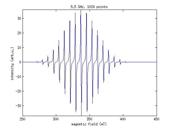

Stefan, hello. Thank you for the answer. Using your advice, I managed to imrove my graph, it doesn't have any unnecessary lines. :)

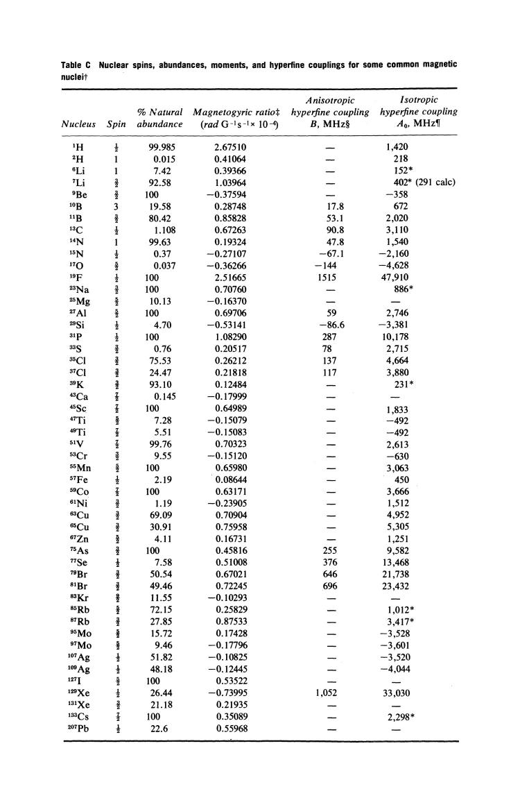

But I have questions again. The first, I took hyperfine coupling from the book "Electron Spin Resonance. Elementary Theory and Practical Applications" authors Wertz and Bolton. Here they are - table c. What's wrong with them? The second question is if I want to change the orientation of magnetic field <110> instead <100>, should I use Euler angles or any another tools of EasySpin?
simulation of the EPR spectrum of the F center in KCl considering the first coordination sphere only
Table C Nuclear spins. abundances. moments. and hyperfine couplings for some common magnetic nucle
2145904 (1).jpg (100.87 KiB) Viewed 11382 times
Re: F-centr in KCl. How to describe the second and other she
I might be mistaken on this but I thought the hyperfine values from that table in Wertz and Bolton correspond to isolated the neutral atoms. Where in your example you have an unpaired electron trapped in the crystal, in which case that unpaired spin density is distributed across multiple atoms so you actually have to scale the interactions down appropriately.

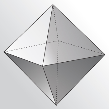

Hello, experts! I try to simulate the spectrum of F-centr in KCl using coordinates of the vertices of a crystall. In this example unpaired electron is trapped into an anion vacancy surrounded by 6 K(+) cations that form the first coordination shell around vacancy at a distance r. But my code doesn't feel Exp.Orientations again. The spectrum looks like <100>-direction, but the angle [0 45 0]*pi/180 corresponds to <110>. Do you have any idea???
And second question. I need to describe the second shell (12 Cl-ions). Can I use the same angles (theta and psi) for that?

The model of first shell in KCL crystal
