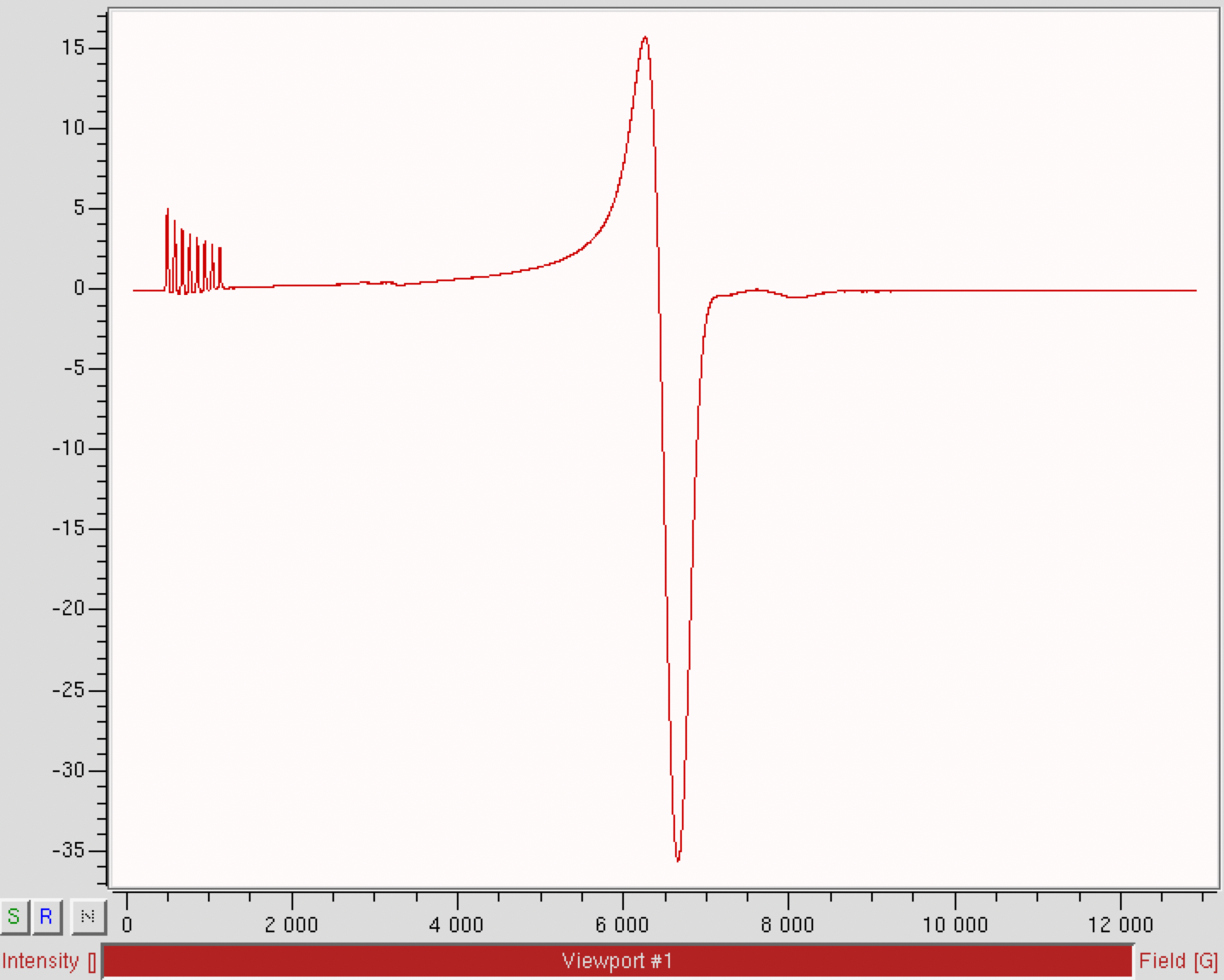

Hello all--after struggling for a while with no progress, I was wondering if it was even possible to simulate this cobalt spectrum (at 20K)? Maybe it's just not possible? The huge differences in line widths makes me think it cannot be done?

It should be possible by including a bit of g or A strain.
