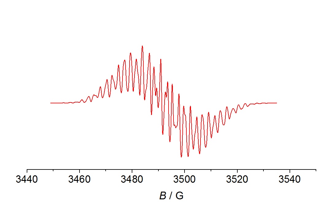

Hello!
I have a little problem with simple simulation of EPR spectrum of isotropic system. The problem is, that I can get a reasonable fit, but the ploted result of simulation is asimetrical and I dont know why, because I used only garlic function, which serves to simulate EPR spectra of isotropic system. Can somebody tell me, please, where I am wrong? The written program and the picture of the resulting fit you can see bellow. Thank you in advance.
Peter

I think you don't use enough points for the resolution/linewidth you have. The spectrum looks more symmetric if you increase Exp.nPoints.

Interestingly, I am having a trouble making my spectrum look asymmetrical, and I tried your script, everything looks normal. Hope someone can explain this.
