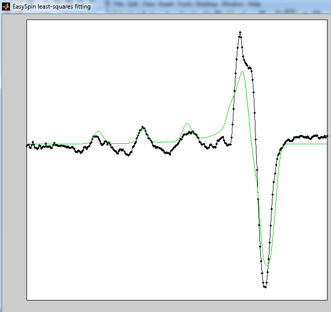

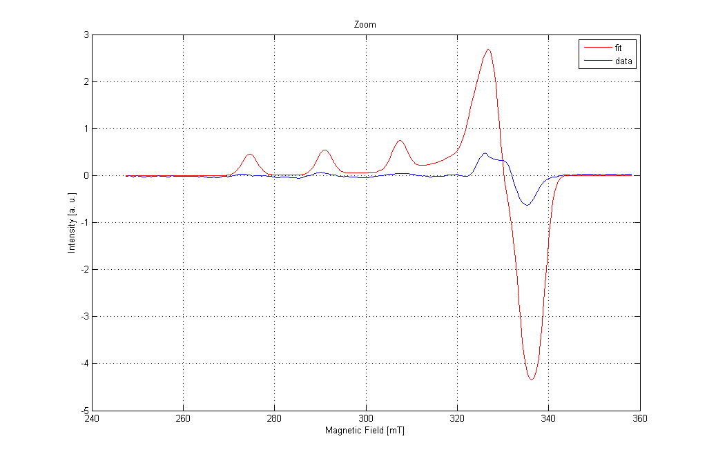

I have one question regarding the fitting procedure in EasySpin:
Is there any kind of normalisation or scaling of the y axis carried out before the fitting? I did not find any clue that there is one in the documentation, but I noticed when I fitted a spectrum, obtaining good results and then using the same parameters to simulate the spectrum with pepper and plotting it, that the simulation gave me a much larger signal. I have attached two pictures of the fitting window and the result of the pepper simulation, as well as my code.
What am I making wrong?
Thank you!
Felix

Fitting window
Fitting window
Pepper simulation result
Re: Normalisation during fitting?
Yes, when fitting, ES scales the results to provide the optimal fit. To replicate the scaling try something like:
% first ensure that the data is in column form
intensity = intensity(:);
y3 = y3(:);
 % calculate the scaling factor
A = (y3' * y3) \ (y3 ' * intensity(zoomStart:zoomEnd));
% scale the simulation
y3 = A * y3;
The above method could also be used to scale a sum of spectra.
In esfit, you can actually specify how you want ES to scale experimental and simulated spectra to fit to each other.
Programmatically, the option is FitOpt.Scaling. It has the basic scaling (to same minimum and maxmimum, etc), but also more fancy least-squares fitting methods that can automatically take care of a constant, linear or quadratic baseline. You can access all these option on the graphical interface of esfit.
