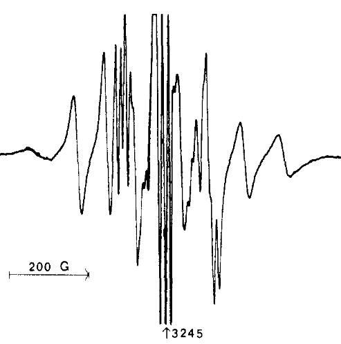

I did try that, and one thing comes out immediately: in my case, and other fluid solution spectra in the literature, each spin system may exhibit very different linewidths. However, using pepper imposes a unique linewidth to the entire spectrum and simulations are really very off the mark.
In Eaton & Eaton's original CUNO program, each line was assigned a linewidth of A + BmI + CmI2, where mI is the nuclear spin. Subsequently, arbitrary line widths were introduced (Inorg. Chem., 1982, 21, 1094).
See also the figure below the very narrow nitroxyl and much broader vanadyl lines:
