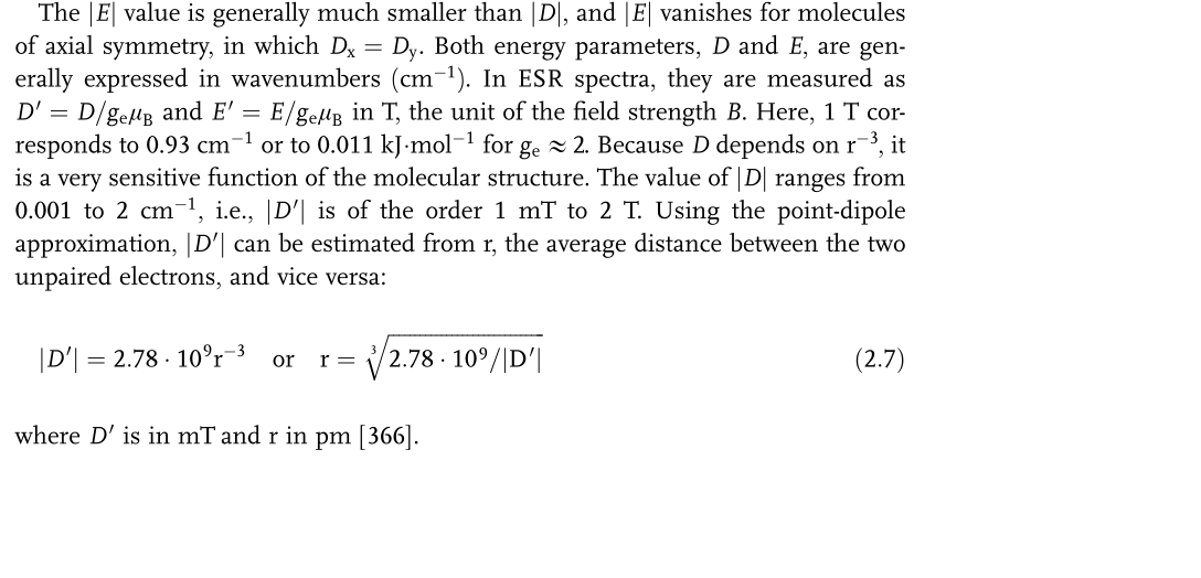

Hello and sorry for the dumb question. I have a powder spectrum of an organic triplet biradical collected at room temp. I can roughly simulate as an S =1 system and lwpp seems to give better fits than DStrain (although that might be my own lack of experience with powder spectra!). I get out D = 26 MHz and E = 1.1 MHz which converting to cm^-1 gives D = 0.001, E = 6.3e-5. At the very least, the D value is consistent with other biradicals of this type.
The problems start when I try to use the attached equation to find the distance between unpaired electrons. The screencap is from the textbook "Electron Spin Resonance Spectroscopy of Organic Radicals" by Gerson and Huber (Wiley, 2003) page 28. When I try to calculate D' using the equation in the text \D'\ = D/(ge*ub), I get crazy numbers, D' = 5e19 T which then gives an electron distance using equation 2.7 as 0.003 pm! Following reference 366 doesnt help (J . Am. Chem. Soc. 1975, 97, 696), they use an entirely different equation.

There are two slightly different forms, which depend on whether the two spin are like or unlike. And what I mean by like or unlike really comes down to there being appreciable exchange coupling or spin correlation, you can find some discussion of this in Slichter (3rd ed. pg 79-80), and it deals with the terms from Abragam's dipolar alphabet of interactions.
But the short of it is that you get:
% like electrons
%D =@(r) 2.785/r^3; % mT nm^3
%D =@(r) 78.049/r^3; % MHz nm^3
% unlike electrons
%D =@(r) 1.8526/r^3;% mT nm^3
%D =@(r) 51.92/r^3;% MHz nm^3
r = @(D) nthroot(51.92./D,3); % nm
nuperp = (mu0/4/pi)*bmagn^2*gfree^2/(1e-9)^3/planck/1e6; % MHz nm^3
%D = nuperp*(3*cos(theta).^2-1); % MHz nm^3
A couple notes:
  • The first, like, value is common in the photosynthetic literature; while the second, unlike, value is what you will find in the DEER literature
  • There is an extra 3/2 factor when the spins are like.
  • This assumes the free electron g. You could divide it out and add in your own g-values(if there are significant differences)
