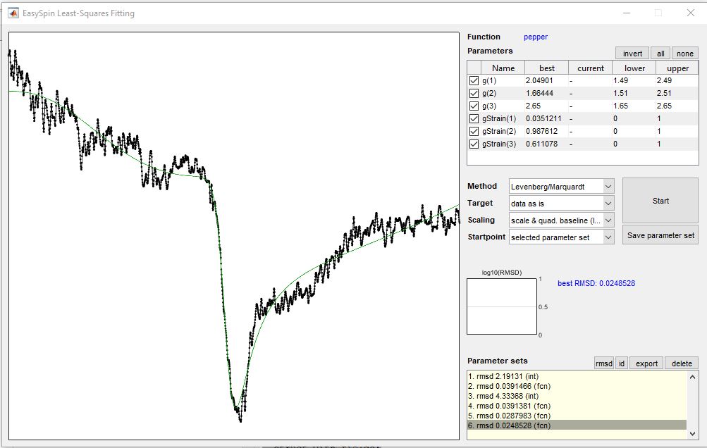

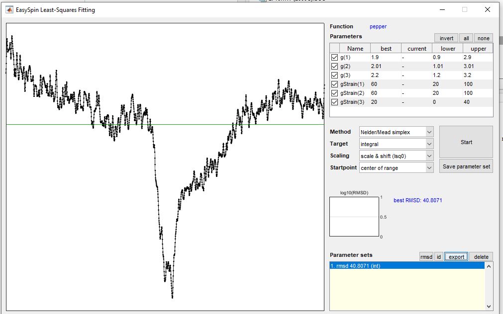

I am trying to simulate the EPR data for metalloenzyme (cobalt), by using the below parameters. The problem is I couldn't able to simulate the EPR data using the below parameters. My aim is to calculated E/D values for the spectrum. I am not understanding where I went wrong.
Can anyone kindly help me to sort out this problem?
Thank you in advance.

esfit(@pepper,spc,Sys0,SysVary,Exp);
Matlab error:
WARNING: No resonance fields at 9.64 GHz between 2400 and 4399 mT.
Check field range and spectrometer frequency.
Warning: Rank deficient, rank = 1, tol = 1.986027e-11.
In rescaledata
In esfit
In rescaledata
In esfit

Looking at the warning WARNING: No resonance fields at 9.64 GHz between 2400 and 4399 mT., it looks like you might have entered the field range in gauss. EasySpin expects it in units of millitesla.
