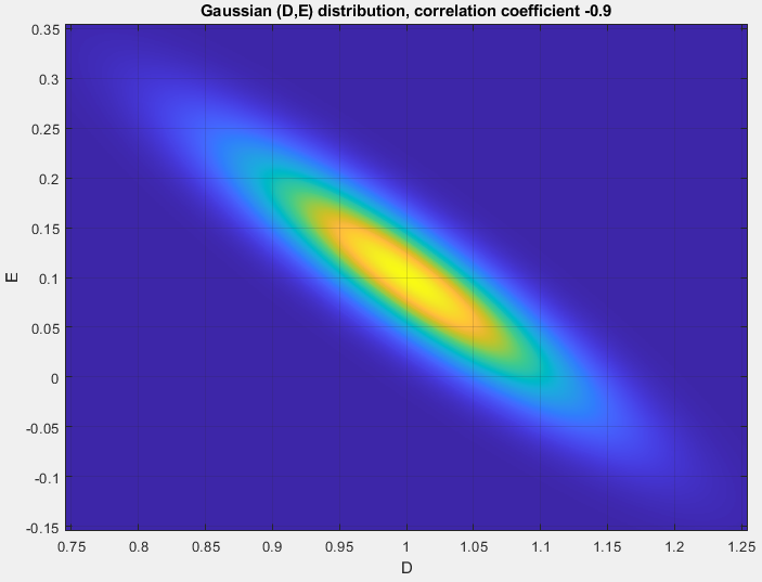

For example, If I have a Fe(III) complex with D = [1 0.1 ]cm-1. Now, if I apply Dstrain = [0.1 0.01] cm-1. That means D will have a gaussian profile over a range of D+- DStrain. Thus, DstrainCorr would be a number for each confirmation. No?
How is this converted into a coefficient?
Re: DStrainCorr
Maybe a picture helps. Here is a Gaussian (D,E) distribution with a correlation coefficient of -0.9.
And here is the script that generated this plot:

SoniaChabbra
Joined: Mon Mar 23, 2020 4:44 am
Re: DStrainCorr
Post by SoniaChabbra »
This helps to visualize it. Many thanks Stefan!!
