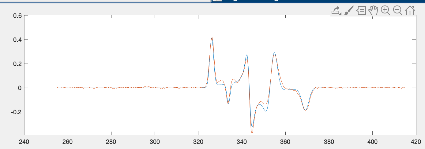

Is it possible to use the esfit fitting function in EasySpin to fit a difference epr spectrum? i generated a difference spectrum because subtracting two spectra shows a transition from one state to another and eliminates interference from overlapping signals that do not change. it should be the same as fitting S=1/2 two spin systems, just that the spectra for one of the spin systems should be multiplied by -1. I have attached an experimental spectrum along with a simulation that gets the parameters pretty close, although a better fit could definitely be achieved with the fitting algorithm
Screen Shot 2021-01-11 at 5.33.36 PM.png (53.16 KiB) Viewed 3517 times
