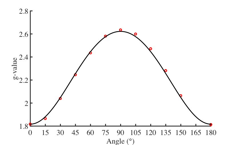

How do we fit a roadmap to data to extract parameters such as gx, gy, gz etc? Attached is an example of the experimental data (symbols) and simulation of a roadmap. Line represents simulation, not a fit to the data.

Use esfit with a custom function, say mysim. This function should call resfields to calculate the resonance fields for all the orientations where you have experimental data. As data for esfit, supply the list of experimental field values.
