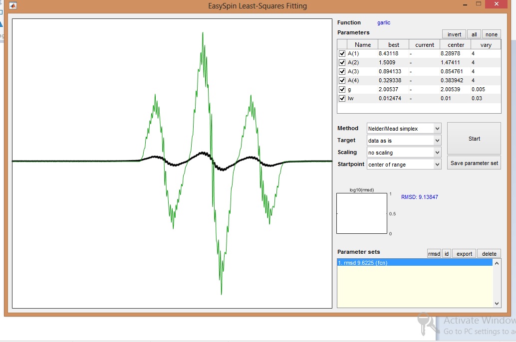

Thanks. But I should have attached the EPR spectra earlier. I am attaching now. Do you think, the rescale would work ?
Simulated (green), exp. (black)

Just try it! Why did you choose the "no scaling" option? it looks like it could fit.

Ok. Now the problem is solved. Earlier, I was using easyspin 5.2.24 which has ''bug'' problem. The ''lsq0'' was giving flat line. Now, I have upgraded to the latest version, and it works fine. But Thanks for the suggestion.
