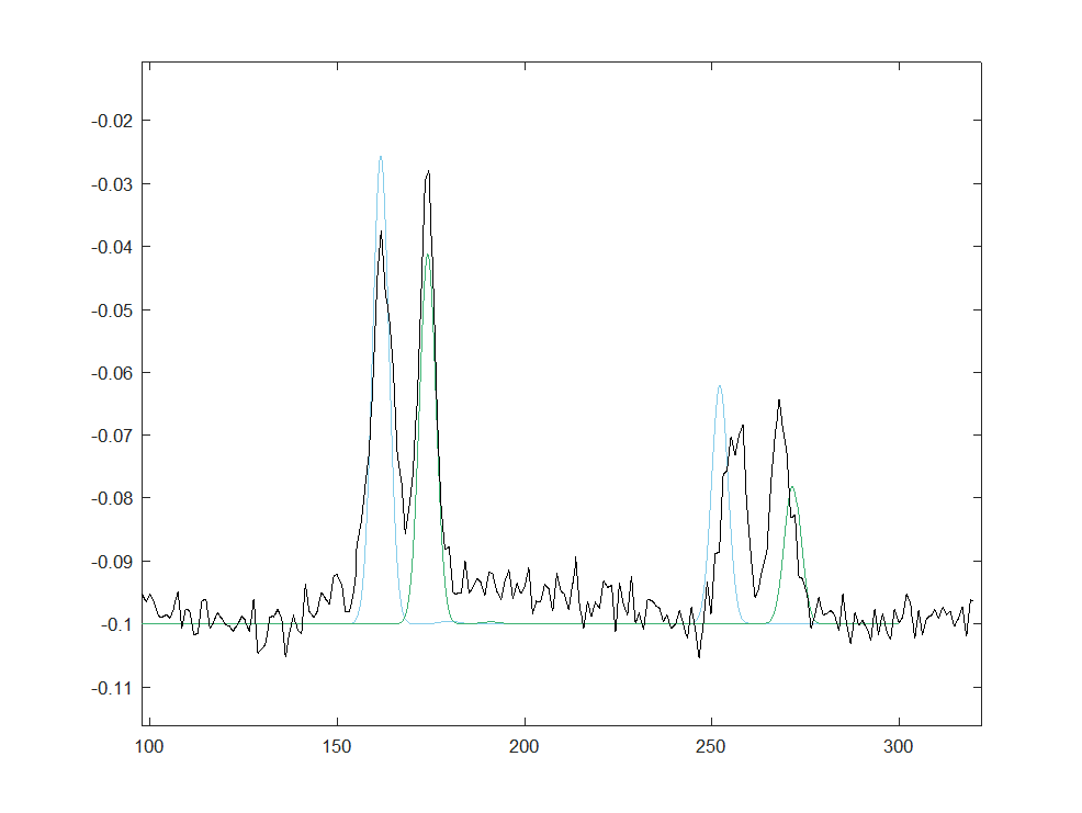

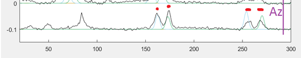

The problem is these shifts from the experimental that are marked with red.
Sys.S = 3;
Sys.g = 1.99;
Sys.D = -3e4*[0.281 0.0461];
Sys.aF = [20 -40];
Sys.Nucs='55Mn';
Opt.nKnots=[20 3];
Opt.Method = 'matrix';
Opt.Threshold=1e-4;
Par=struct('ExciteWidth',100,'nPoints',1024,'Harmonic',0,'Temperature',4.8);
Par.mwFreq=94.017;
Par.Range=[0 300];
A=[-95 -97 -91;-102 -103 -97];
lw=[5;5]; scal=[ 0.5 0.5];
for n=1:2;
Par.Field = 1980;
Sys.A=A(n,:)
Sys.lwEndor=lw(n,:);
[x198,MnSim198] = salt(Sys,Par,Opt); MnSim198=MnSim198/max(MnSim198);
LOR= gaussian(x198,0,300);LOR=LOR/max(LOR);
MnSimA198(:,n)=scal(n)*LOR.*MnSim198;
plot(x198,MnSimA198(:,n)-0.1); hold on
I cannot add the experimental file.. Thank you! :-)

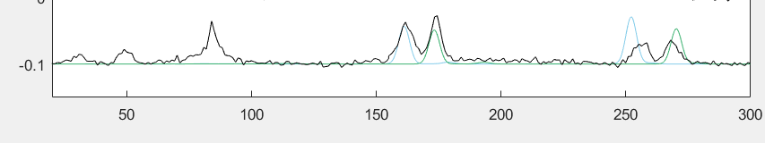

This is with ExciteWidth=1 and nKnots=[180 6], but it is still the same..
There is a small term missing from the hamiltonian i am using.
For example, for the smaller hyperfine. The experimental peaks are 162MHz and 256 MHz.
It should be: 2A-ω=162 and 3A-ω=256 and 256-162=A
ω~21MHz
The A calculated from each equation is slightly different: 91.5 92.5 94
Re: Shifted peaks in EDNMR spectra ?
You might be seeing crossterms between zero-field splitting and hyperfine coupling.
Maria
Joined: Wed Jan 11, 2017 7:36 am
Post by Maria »
what does this mean? I don't understand..
The presence of significant zero-field splitting (S>=1) will affect the quantization axis of the electron spin, which in turn affects the nuclear resonance frequencies via the hyperfine coupling. As a result, the nuclear peaks are slightly shifted compared to the case S=1/2.
Maria
Post by Maria »
But, this isn't calculated by easyspin already?
I corrected a bit the intensities.. for the peak positions I can't do anything..
