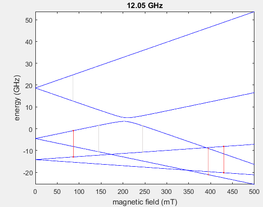

Thank you very much! I tried again, but it seems I still could not get the result I want. The bottom two splitting (see attachment) is different from on the picture I uploaded before. Could you tell me where is the problem? Please. By the way, how can I mark the eigenstate for each level, like |1/2>,|3/2>…
Here are the new codes
mySystem = struct('S',5/2,'g',2.0029,'D',5515.5); mySystem.aF= [760.5 -327.6];
Ori = [0 0]; FieldRange = [0 500]; Freq=12.05; levelsplot(mySystem,Ori,FieldRange,Freq)
And when I modified the FieldRange as= [0 100 500], the lines represent for permission and forbidden transition could not display properly. How can I modify it? Thank you.
- fig2.png (17.64 KiB) Viewed 2862 times

In EasySpin, you can't enter a-F (difference between a and F), but a and F separately in
To calculate the eigenstates, use
If you set the field range to
Sys.aF
. Check the documentation on how these parameters are defined in EasySpin.To calculate the eigenstates, use
sham()
.If you set the field range to
[0 100 500]
, then the energy level diagram will only be calculated at these three field values and will be very coarse. Use [0 500]
to get a finer grid, or use your own grid, for example 0:2:500
