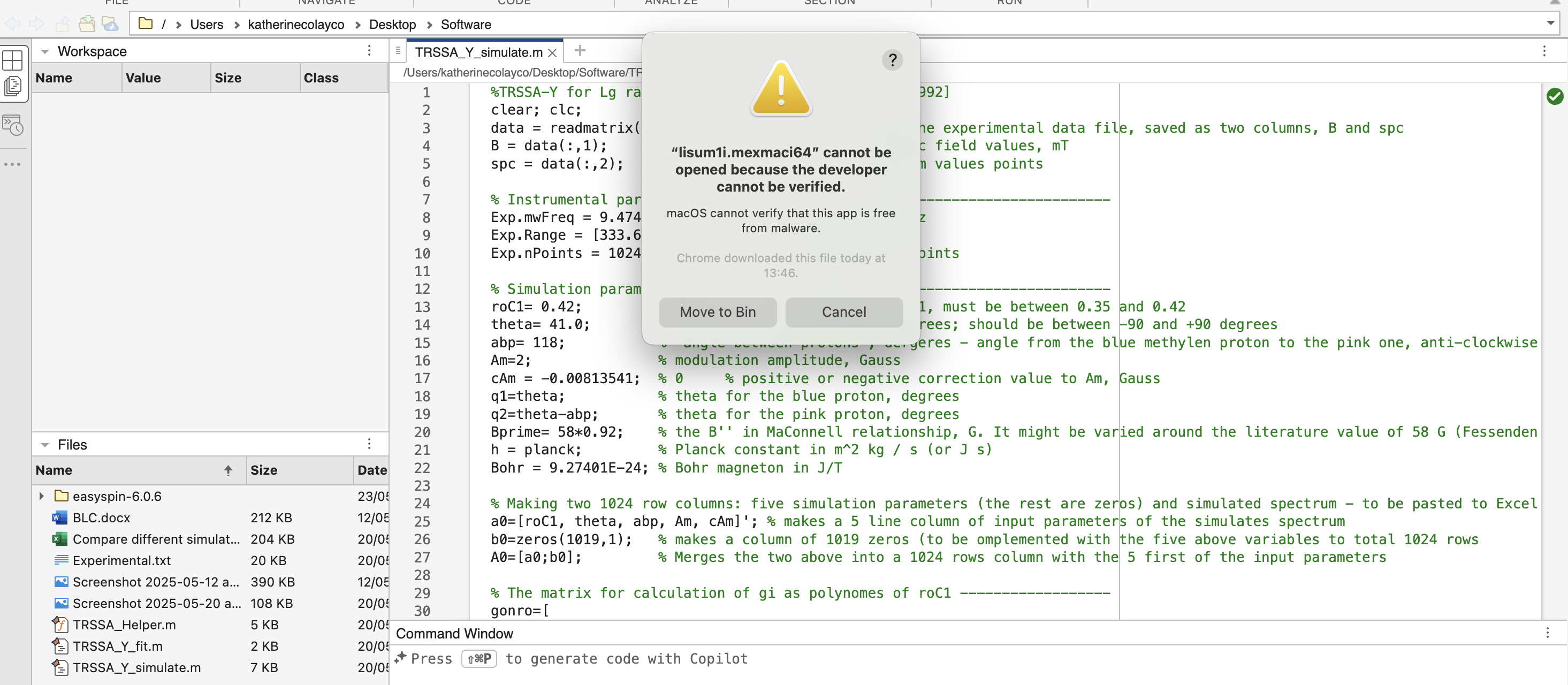

I am using Mac as of the moment and using Easy Spin for Matlab. Upon setting the path(easy spin version 6.0.6) and uploading template and running it, this is showing please see attachment.
this is also on the command window info:
Invalid MEX-file '/Users/katherinecolayco/Desktop/Software/easyspin-6.0.6/easyspin/private/lisum1i.mexmaci64':
dlopen(/Users/katherinecolayco/Desktop/Software/easyspin-6.0.6/easyspin/private/lisum1i.mexmaci64, 0x0006): tried:
'/Users/katherinecolayco/Desktop/Software/easyspin-6.0.6/easyspin/private/lisum1i.mexmaci64' (code signature in
<07BD334E-7CE6-3F9E-8558-EECF58F30796> '/Users/katherinecolayco/Desktop/Software/easyspin-6.0.6/easyspin/private/lisum1i.mexmaci64' not
valid for use in process: library load disallowed by system policy),
'/System/Volumes/Preboot/Cryptexes/OS/Users/katherinecolayco/Desktop/Software/easyspin-6.0.6/easyspin/private/lisum1i.mexmaci64' (no such
file), '/Users/katherinecolayco/Desktop/Software/easyspin-6.0.6/easyspin/private/lisum1i.mexmaci64' (code signature in
Error in pepper
Error in compisoloop
Error in pepper
Error in TRSSA_Y_simulate (line 104)
[F,int] = pepper(Sys,Exp,Opt); % defines field and intensities as two rows
I'm just really confused and need help on this. Since I cannot use windows, wherein I am using Mac.
Thank yoy!
Screenshot 2025-05-23 at 13.46.59.png (834.65 KiB) Viewed 173 times

You might need to recompile the mex files, see the Compiling mex files section in https://easyspin.org/easyspin/documenta ... ation.html.
Posts: 1136
Re: Easy Spin with Mac
I myself don't have a Mac, so I am unable to reproduce this. Googling shows that there are several ways to circumvent this.
MacOS adds a com.apple.quarantine attribute to executable files downloaded from the internet. The error message is shown because the file has this attribute.
You can use the command xattr to delete the com.apple.quarantine attribute:
xattr -d com.apple.quarantine lisum1i.mexmaci64
You need to be in the correct folder, or provide the full path.
Please let the forum know whether this worked.
