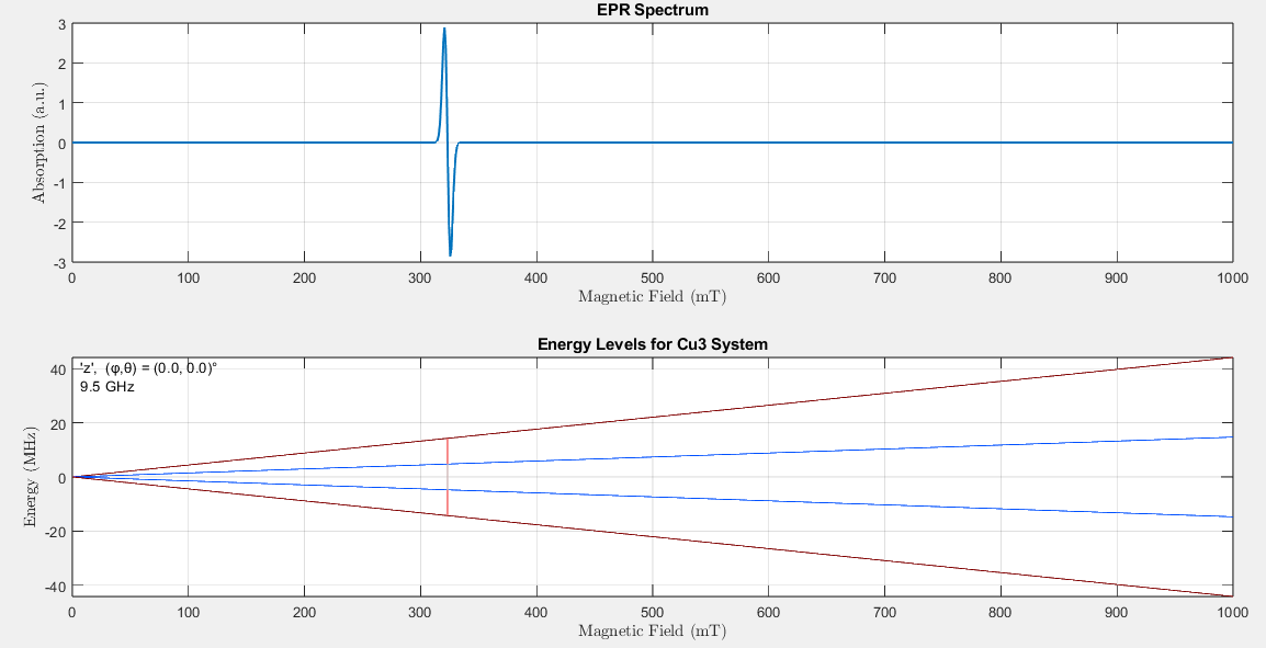

I want to simulate a spin triangle. In a first time I want to plot the energy levels of three S = 1/2 non-interacting spins.
I do not understand why instead of having a ground state corresponding to one S = 1/2, I get a completely different behavior (S = 3/2)
Am I missing an argument that can explain the observed energy levels?

Re: Three non interacting spins simulation
The simple answer is that you have no coupling between the spins so at zero field the S=1/2 and S=3/2 manifolds are degenerate. So in your levelsplot, the two different manifolds overlap and it looks like you're observing just the S=3/2 manifold, when in reality you're observing both manifolds, its just that the S=-1/2 -> 1/2 levels overlap. If you were to add in some isotropic exchange coupling, you'd lift the degeneracy between S=1/2 and S=3/2 and see the differences.
