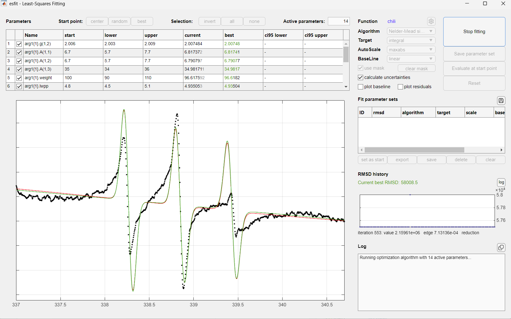

I am new in easy spin. I am trying to fitting an epr spectra using the following code. but i am not getting the exact fitting. Can you guys help me to find out what i need to change for the fitting
Screenshot 2024-11-11 221414.png (158.93 KiB) Viewed 41563 times

It looks like you have some nonlinear baseline issues. Maybe try to correct them before fitting. Your spectrum clearly has two components. It could just be that you are stuck in a local minimum away from the global minimum.

@Stefan Stoll, thank you Stefan, I am new to Easyspin and had lots issues during the spectra fitting. I want to ask about how to tell from the spectrum, "it clearly have two components." Thank you.
Re: Two component fitting
The high-field line (the right-most of the three) has an intense sharp and a more shallow wide component.
