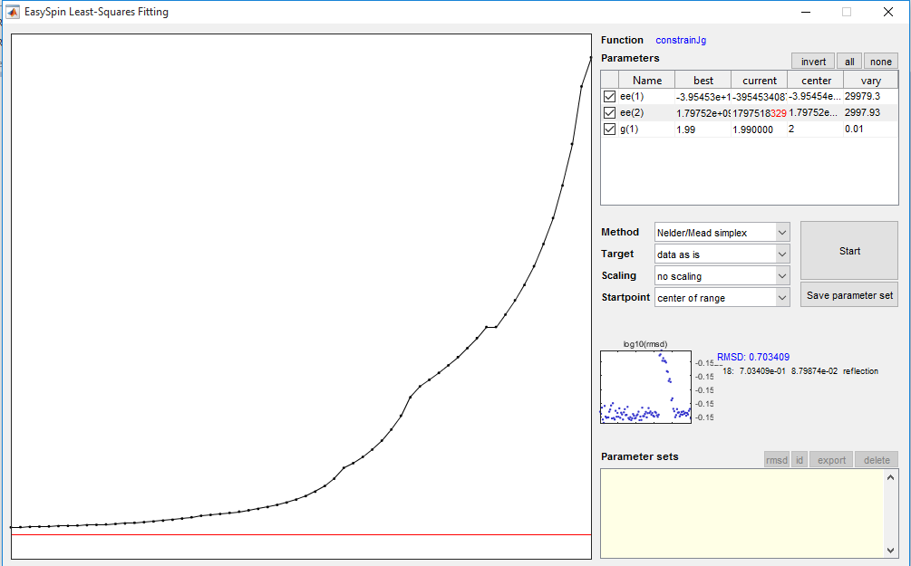

I want to resume again the case,
two coupling constant J1 and J2 and one g to fit a Chi vs T curve.
the code is

the result is the following
fit
fit
My questions ;
FitOpt.OutArg = [1 1]; this is correct to fit J1 J2 g for these data using input Chi vs T
why the fitting is not ok,
is it a problem of units or there is another problem
thank you
