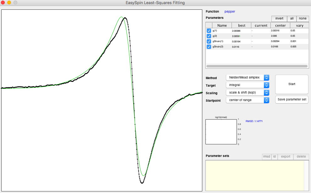

The ESR data (attached) of Na in Si is broad on the left side compared to right. This is a powder pattern.
Any suggestions on what fitting parameters should I use to capture that broadening.
I was thinking this could be axially symmetric g. I did use 2 separate g-values but that does not help to fit that feature in the left hand side of ESR data.
Thank you
Lakshmi

Help with fitting parameters
- ESR spectrum
- Screen Shot 2015-11-16 at 9.57.08 PM.png (62.41 KiB) Viewed 5251 times
- Posts: 1150
Re: Help with fitting parameters
Two things: (1) In the fitting, you could try to vary the g-strain as well. (2) Include some Lorentzian broadening (
Sys.lwpp = [0 0.1]
).Re: Help with fitting parameters

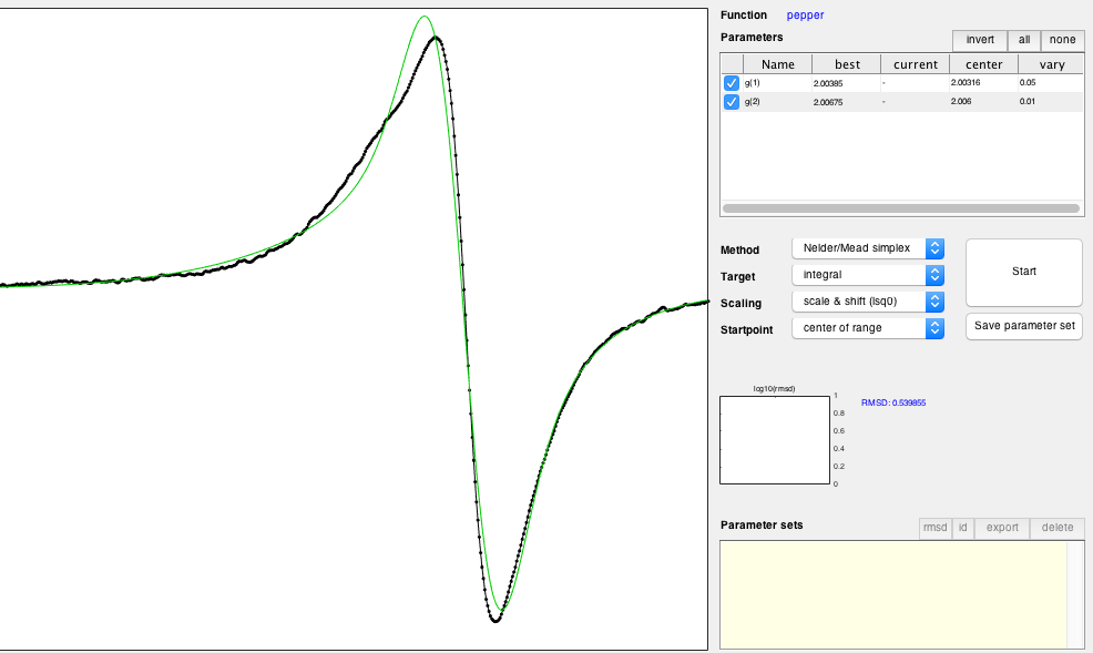

Thanks Stefan!
I tried varying the g-strain and added some Lorentzian broadening. It seems to help.
When I start the simulation I see that at some point there are 2 peaks and then eventually it becomes one broad peak. I am wondering which parameter causes that to happen?
There is a new error that appears when I run the code:
** Spectrum exceeds sweep range. Artifacts at lower and upper limits possible.
Here is my code:
Here is my code:

- Screen Shot 2015-11-17 at 11.11.48 AM.png (71.18 KiB) Viewed 5239 times
- Posts: 1150
Try to search around a little more in the parameter space you have, but it might be that you need to include two lines. However, always keep in mind your sample and make sure your model (one or two spin systems, anisotropic g, presence of g strain etc) makes physical sense.
