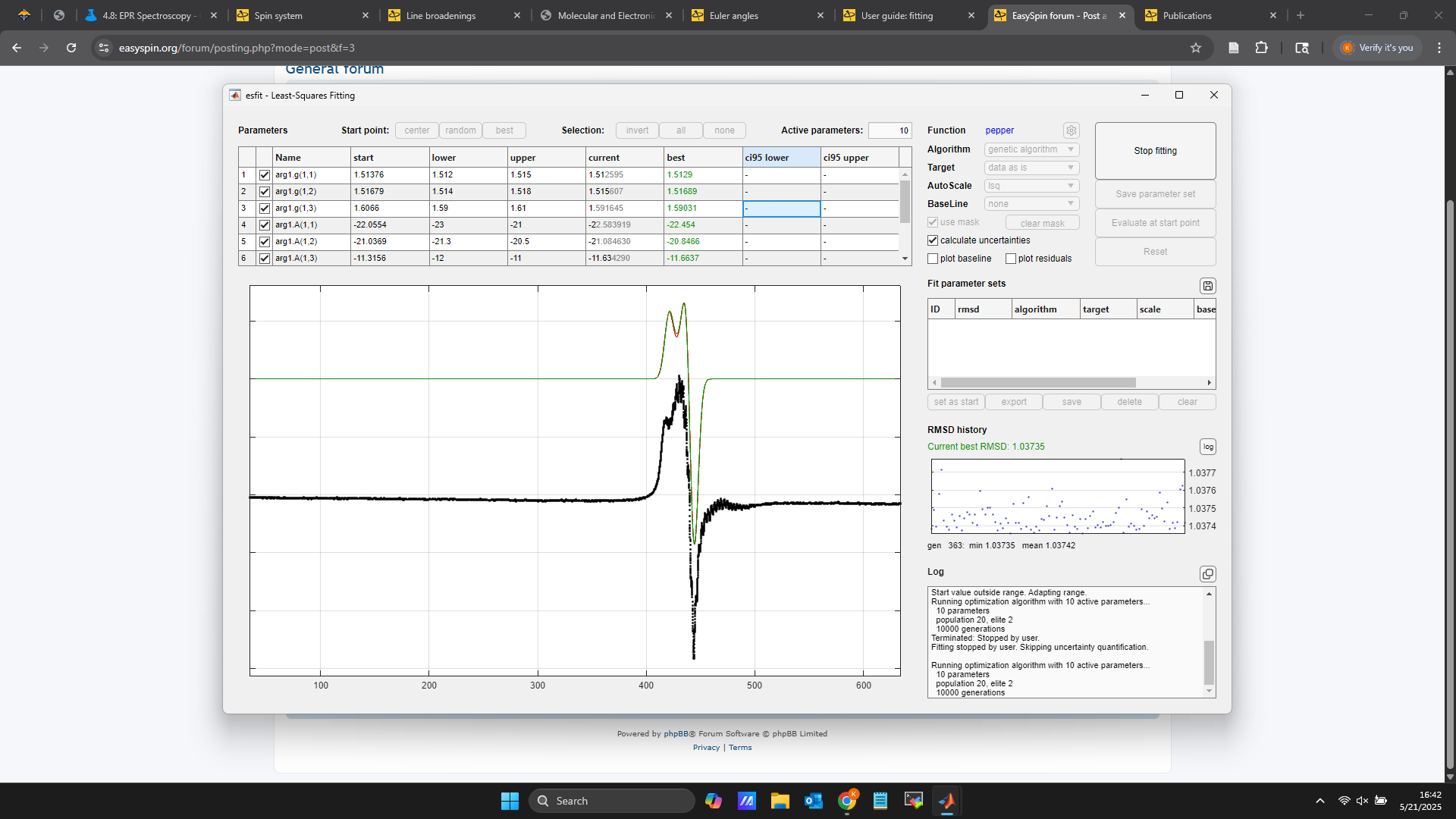

I am trying to model hyperfine with the code below. I can see the hyperfine at lower lwpp values, however, increasing the line broadening to more accurately represent the experimental data, I lose visible hyperfine. Here is what I am using to model my system.

I have attached a picture of my attempted modeling. I am new to epr and would appreciate any help with this. Thank you.

Your code snippet shows that you only have a single 193Ir nucleus (spin 3/2) in your spin system. That will give you at most 4 lines at g_parallel (1.616...) and at g_perpendicular (1.517). Your experimental spectrum might be showing (super)hyperfine splittings to ligand nuclei. In that case, you'll have to include more nuclei in your spin system.
