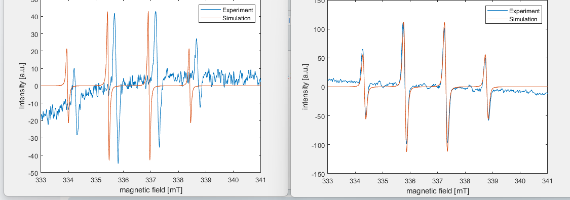

I have a problem with matching both simulation and experimental data for some of my data. The weird thing is that there are data which already is matched by its simulation. But, some of another data does not.
Why could be that? Thank you.
Screenshot 2023-07-26 224117.png (45.24 KiB) Viewed 5780 times
Re: Urgent: Matching simulation with experimental data OH Radicals DMPO
I am not sure what you are asking for, but it looks like the left-hand spectrum has an incorrect field or g offset, but the one on the right is spot on.
