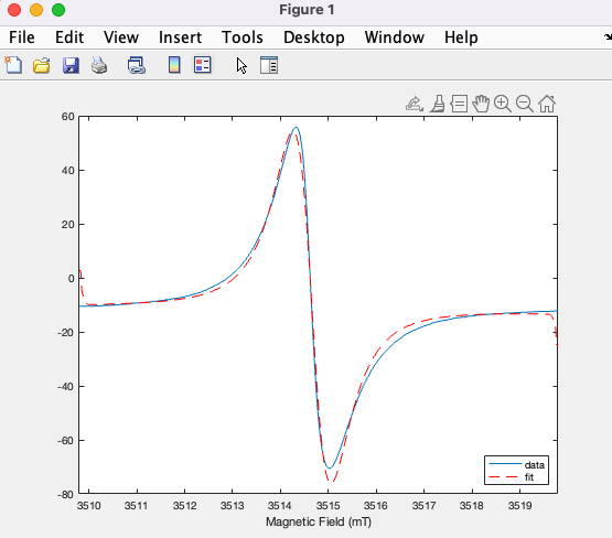

I have noticed that when I run esfit('pepper',spc,...) I am getting fits that don't behave as a Lorentzian near the edges/boundaries of the fit.
The output spectrum seems to suddenly jump in amplitude at the edges, giving an erroneous fit.
Screen Shot 2023-01-24 at 10.29.29 am.png (30.13 KiB) Viewed 50760 times
When the gain on the experimental spectrum is high enough, you can't really notice these jumps in the fit, but when you do low-gain spectra like the attached 'EasyPepperTest' it is a significant error.
I couldn't find any mention of this in other posts and I haven't been able to fix it with any FitOpt.Scaling settings ('lsq1', 'lsq2', 'minmax', etc). Can anyone identify the cause of this and help to fix it? I don't want to manually change the output fit spectra to remove these non-Lorentzian artefacts but I'm unable to find a way to fix it within the EasySpin documentation.

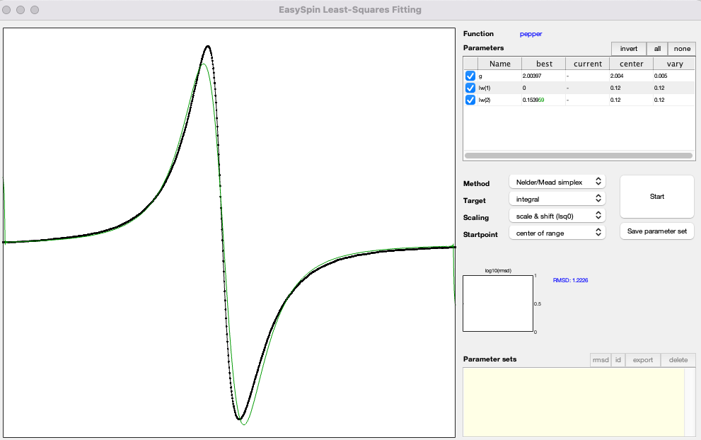

It's worth noting that this also occurs for the GUI version of esfit, not just the CLI:
Screen Shot 2023-01-24 at 10.42.08 am.png (52.62 KiB) Viewed 50759 times
Re: Pepper fitting with esfit has bad edges/boundaries
This is an artifact from the inclusion of the field modulation and the extremely narrow sweep range. You can think of the field modulation as an additional linewidth which the spectrum is convoluted with, as such if it is non-zero at the edges you're likely to get weird artifacts. So in your case, an extremely narrow sweep range and linewidths which don't allow for the spectrum to reach close to zero at the edges makes for convolution artifacts.
FYI the baseline('lsq1') is applied after the modulation so that won't help matters.
Unless your modulation is large relative to your linewidths (and you have structure), its effect is negligible and you can typically ignore it.
Thank you Matt. Removing the line "Exp.ModAmp = 0.01;" completely fixes the issue. Thanks for explaining the situation where including modulation effects will lead to weird artefacts.
