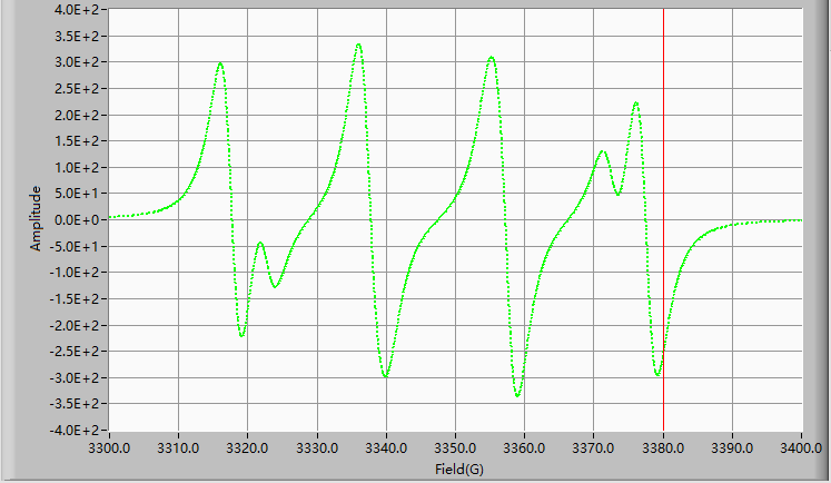

I got a simulation which I cannot understand.
I try to simulate a 1/2 freeradical with Cl atom. With the natural abundance of mixture of Cl isotopes, it gives the spectrum(green line):

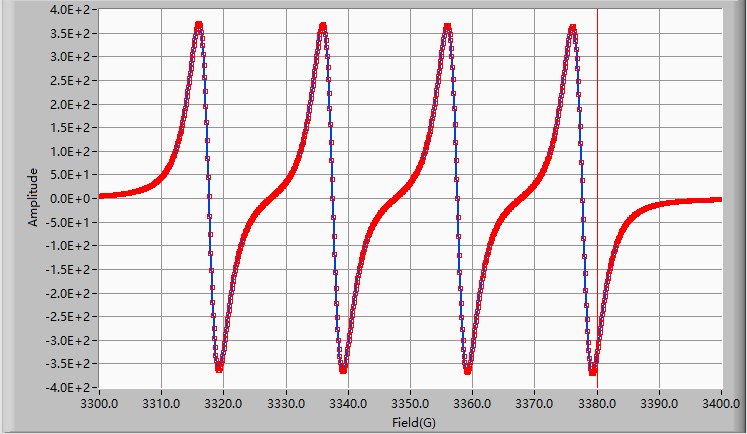

With the enriched 35Cl or 37Cl isotope, both of them gives the same spectra (red-35Cl, blue-37Cl):
The question is, both of the 35Cl and 37Cl isotopes have the same spectrum, but the mixture shows differrent structures, why?
All the g and A parameters are the same.

Re: why the simulated spectra are different between the mixture isotopes of Cl and the single enriched 35Cl or 37Cl
When using specific isotopes, the provided hyperfine values directly determine the splitting, however when using the natural isotope abundance, the input hyperfine value gets scaled by the nuclear g-value difference. So in your case the lower abundance 37Cl should use a set of hyperfine values scaled by 0.456/0.5479 = 0.83.
Matt is right.
For completeness: You can get the isotope table by typing isotopes, and you can get the nuclear g values with nucgval('35Cl') etc.
