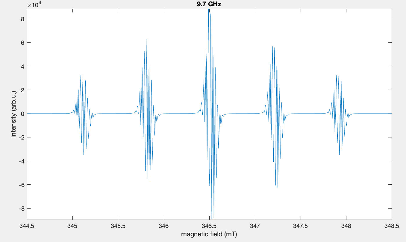

Hello all--I was trying to simulate this spectrum from the literature, just because it looked interesting. I have attached the article, as well as my first attempt. Any guidance will be much appreciated!

You have to use additional simulation function exchange(). See file exchange topics viewtopic.php?f=8&t=309 and viewtopic.php?f=8&t=465
Good luck.
