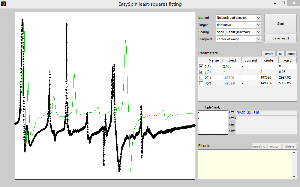

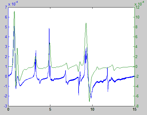

The last two lines are the normal pepper simulation with my initial parameters. as following,
pepper simulation
pepper simulation
However, it is very different from the esfit simulation from the center of the variable.
esfit simulation
esfit simulation
I guess this might be because my field sweeping rate is not a constant: the sweeping rate is lower at higher field to avoid quenching. The result is that the number of the data points in various field ranges are not uniformly distributed. I enclosed my data file below.
data.zip
experimental data
(47.2 KiB) Downloaded 736 times
In the pepper simulation, I plot the spectra by the function of "plotyy", where the specific relation between the spectrum and field are included in the data;
while in the esfit function, the spectra information is introduced by a 1D array(the abscissa values are not included), and they are assumed to be uniformly distributed in the whole field range(are they? otherwise one need the abscissa values).
